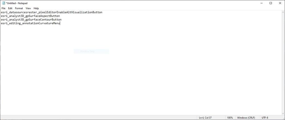

Scott - in further testing, I too created a new tab and tab group, searched for Shaded Relief and added it to the new tab.  Same thing you're seeing, it's greyed out.  This got me thinking was it only this raster function and not others?  So I searched for NDVI or Windchill - couldn't find those functions at all!  So I searched for and added Contour, Aspect and Curvature to the new tab as those are raster functions too.  Would those work?  They did!  Hmmm... In the Project-Options-Customize the ribbon, went to the commands area and the right of the UI and did a right-click - Copy ID to clipboard too see what was being called by ArcGIS Pro.  Interestingly enough the Shaded Relief Raster Function threw a esri_datasourceraster_pixelEditorEnableAltVisualizationButton while the others threw GP tools (see image below.)  Further down the rabbit hole we go.  Next, I wondered well can I add a raster function to a model in ModelBuilder?  I tried to add a raster function and it looked like it might work but then failed last minute.  So this got me thinking again...perhaps raster functions are constrained to the Raster Functions Pane and the Function Editor only and are not exposed to the greater ArcGIS Pro app!  I've got a question out to the ArcGIS Dev Team right now to confirm my suspicions...more to come!
