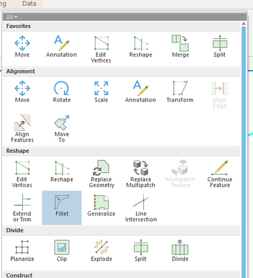

Hi,
I'm trying to find a way to make a curve bwtwen two connected lines with a given radius. In ArcMap Desktop there is a solution.
Creating a fillet curve connecting between two lines
(https://desktop.arcgis.com/en/arcmap/latest/manage-data/creating-new-features/creating-a-fillet-curv...)
But I'cant find this in ArcGIS Pro.
David_Brooks
MVP Regular Contributor
@VassilisTrigkas1974 fillet is available from the tools menu, and works in the same way

VassilisTrigkas1974
Thank you very musch  Brooks_SummitGeo
You save my time!!!!
Thank you again.

In Pro is there a way to use the fillet to draw new line and NOT clip the existing? In Map there was the check-box option to "Trim Existing Lines"
