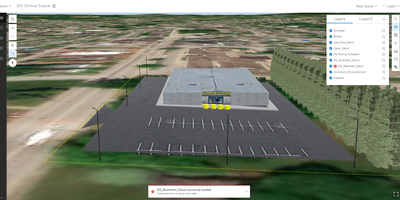

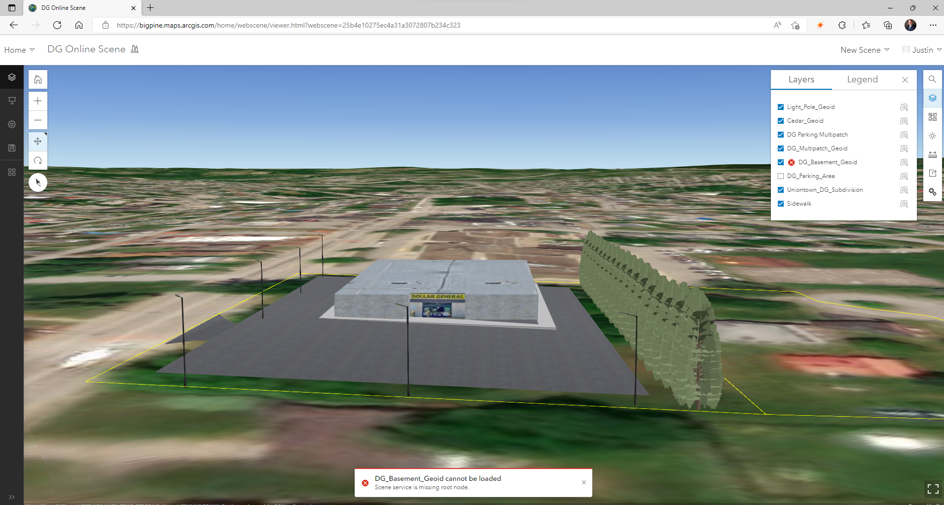

Hi Everyone,
Created a new scene in ArcGIS Pro, analyzed with no errors, shared to ArcGIS online and get "Scene service is missing root node" errors. First try I got 3 errors, second try I got one.  I waited an hour after uploading on the second attempt since I read that it can be an issue from still processing online. I checked this morning and it is still there.  Do I have to try yet again?  Any ideas?

Update, I had made some updates to the scene in ArcGIS Pro, added some cylinders (to depict bollards) and trash bins using point features extruded with 3D models.  The result when sharing was that all but that same multipatch "DG_Basement" feature class came in fine.  Still get the same error on that multipatch.  I might just create a new multipatch from scratch and try again.
I have to start a new thread because the cylinders come in online much larger diameter than what I have it set at in ArcGIS Pro.
