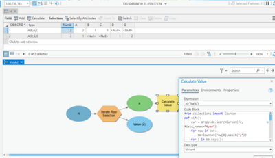

SMehta
See if this helps
from collections import Counter
def x(fc):
    cur = arcpy.da.SearchCursor(fc, field_names="type")
    for row in cur:
        bb=Counter(row[0].split(";"))
    for i in bb.keys():
        arcpy.management.AddField(r'C:<path>\Hussain\Hussain.gdb\H', i, 'LONG')
    with arcpy.da.UpdateCursor(fc, field_names=list(bb.keys())) as cursor:
	    for v in cursor:
		    cursor.updateRow(list(bb.values()))

Hi @SMehta ,
This for sharing the idea of using Collections::Counter, which is indeed a great way of splitting a text and get a dictionary with the counts. Kudos for that. However, in your code, I don't see you are handling the creation of the same field twice which I assume should fail and using the description for the field name would also fail since the descriptions are no valid field names.
@HussainMalik1 ,
Find below the part of the GetStats function which will now set values to 0 and avoids getting the Null values in the result:
def GetStats(archetype, dct_flds):
    # get the stats from the archetype
    dct_cnts = {}
    for description, fld_name in dct_flds.items():
        dct_cnts[fld_name] = 0
    archetypes = archetype.split(";")
    for description in archetypes:
        if description in dct_flds:
            fld_name = dct_flds[description]
            if fld_name in dct_cnts:
                dct_cnts[fld_name] += 1
            else:
                # this part is no longer required
                dct_cnts[fld_name] = 1
        else:
            # oops, value not defined in dct_flds, report this
            print('{} is not included in dct_flds'.format(description))
            pass
    return dct_cnts

Hi @XanderBakker
Thanks for your code it works perfectly now.
Thanks
