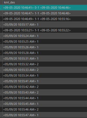

Although the date format is standard, it is wrapped in additional text that is causing troubles for the tool.  Additionally, some rows have multiple dates, which also will cause issues for the tool.
You will need to do some text parsing to extract just a single, valid date format before trying to convert to a date.

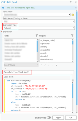

Earlier on you also mentioned using Python for the field calculation. This should return the same result.
def ParseDateTime(tst):
    import datetime
    dt_format1 = "%d-%m-%Y %H:%M:%S"
    dt_format2 = "%m/%d/%y %I:%M:%S %p"
    if "-" in tst:
        txt = tst[1:20]
        dt = datetime.datetime.strptime(txt, dt_format1)
        return dt
    else:
        txt = tst[1:21]
        dt = datetime.datetime.strptime(txt, dt_format2)
    return dt
ParseDateTime(!kml_des!)

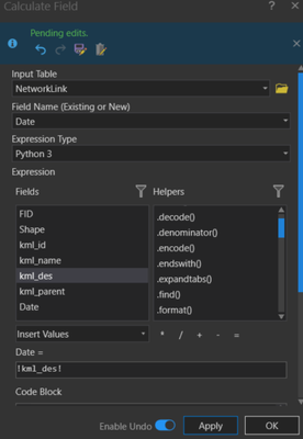

Yes, what you could do is add a new attribute field that is a DATE field type.  Then in the open Attribute Table, right-click on the new DATE field and select Calculate Field.  In the Calculate Field GP tool, calculate the DATE field = kml_desc field.  It "should" convert the data in the kml_desc field to date/time in the DATE field.  Hope this helps!
DonovanC
Hi Robert,

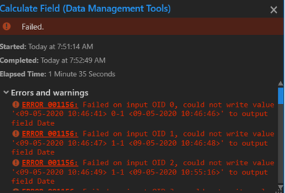

I tried this solution but I get an error when trying to calculate the field. I think it is failing because some records contain 2 dates & timestamps along with numbers at the end of it.
Here is the calculation:
Here is the error I am getting:

In addition to what Joshua mentioned, it seems you have different date notations MM/DD/YYYY and DD-MM-YYYY and there is more than a single date in the text field.
To provide an example to extract the first data based on what I have seen from the screenshot, here is an example with Arcade (in Python this could  be done in a lot less lines):
