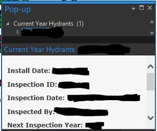

I am using ArcGIS Pro version 2.5.  I have configured pop-ups as you can see in the two images below.
I have read that you can publish the layers and these configured pop-ups will follow to Portal which my version is 10.7.1.
https://community.esri.com/thread/246120-pop-up-created-in-pro-does-not-work-when-published-to-porta...
https://community.esri.com/thread/212571-how-do-you-display-popups-configured-in-pro-with-expression...
My workflow is like the first post's for publishing.  Share tab -- Publish web layer -- I am referencing registered data -- Publishing both Feature and Map Image.  I do not have version issues like the second post with my Portal being above 10.6.
After the publish goes though, when I open the web map and load the data in, none of the pop-up configuration transfers.  The custom text, selection of fields, and expressions do not publish.  I have tried this with the image layer, the feature layer, registered data, and hosted data.

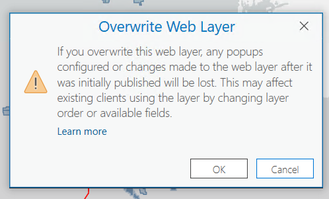

Publishing from Pro (still 3.1) and overwriting these services applies the popup config as configured in Pro, just as it says it will:
It would be great if this issue was resolved so that popup config was applied without needing to overwrite published services from Pro, as the DSC/Python publishing is very useful for portal migration. Otherwise it would be good to know if this is expected behaviour, or a limitation of automated publishing methods.
