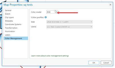

hmmm try it at the map level
color-managed-project-items

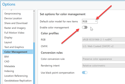

Project backstage, Options, Color Management
might do it for you

CatrinRidyard96
Hi Dan,
I already looked into this and it doesn't seem to change the rasters.
Thanks anyway.
