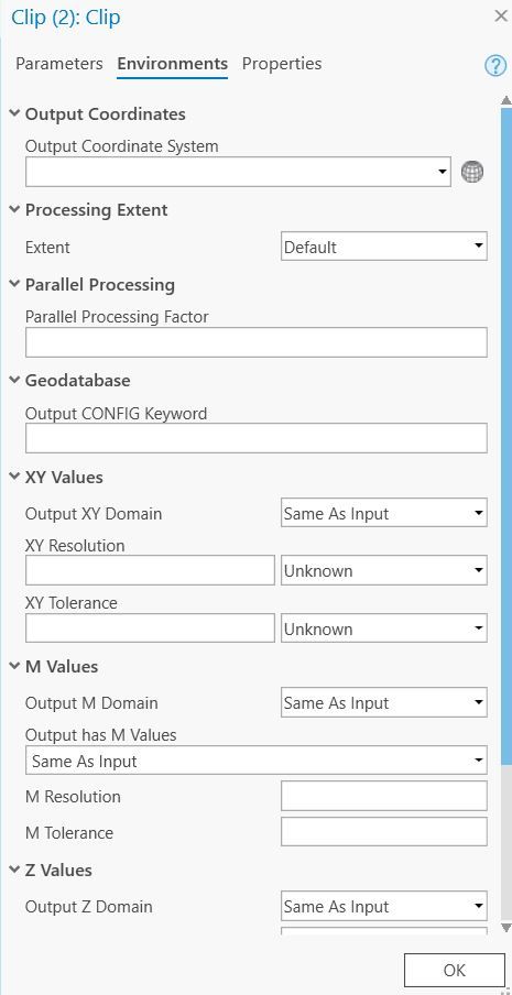

That's strange. Can you take a screenshot of your clip settings?  Are they in the same projection/CRS?

Thanks David. I have set the extent to multiple settings to see if that would make a difference, but it came out the same for each try.

Mary_Murphy
Project to a local projection [PCS] > add the projected layers to a new map > perform the clip.
Ensure that in the Clip environments the output coordinates are the same projection as the inputs layers.
LauraGuthschmidt
This worked perfectly, thanks!
