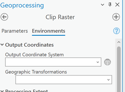

Each tool in arctoolbox has an Environments tab, you can set the cell size etc there in the raster section

Perfect this worked thank you much.
Also if you double-click on the larger raster in the portal you can then see the individual smaller rasters and those can be clipped. Both methods work.

Hi, I am having the same issue, however, I can't figure out how to apply the solution. I found the Environments tab you mentioned but I can't seem to find a way to set the cell size to a bigger size. Thank for your help.
cat206
I'm having the same issue and can't find where to set the cell size either
Hope-Hauptman
You could try the Geoprocessing tool 'Resample' which should work.
