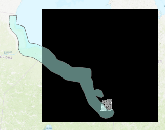

I'm using ArcGIS Pro 2.9.3 and Python 3.3. I have a large number of rasters that I'd like to make have the same number of rows and columns. To do that, I want to set their extent to be the same as a shapefile called Hudson_Plain_coast_Project.shp. I've tried multiple combinations of the Snap Raster and Extent environments, as suggested by this post, but none of them have produced the desired result of all of the rasters having a box of NoData (changed to -3*), like this:
In this image, the teal polygon is the Hudson_Plain_coast_Project.shp that I want to use as the extent. I've used the Feature to Raster tool to make a raster copy of it (named RasHudson_Plain_coast) for using in the Snap Raster environment.
In the Environments tab, it says the project has the correct extent environment, which I set to be "Same As: Hudson_Plain_coast_Project." The left is -2432.32899999991, right 1044642.9029, bottom 5633641.8129, top 6660766.088 (in metres).

I've tried running this code with and without setting the Snap Raster and/or Extent environment, but it has consistently led to the extent being slightly to the side instead of centred on Hudson_Plain_coast.
What do I have to change for my extent to consistently be in the desired location?
