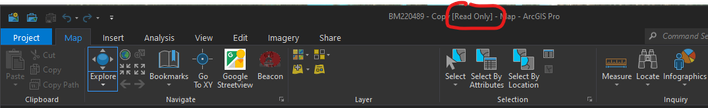

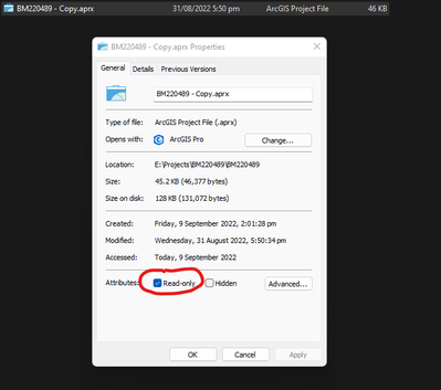

Hi Andrea.  You could temporarily set the 'Read-only' file attribute of the .aprx in file explorer.  Right-click the file and choose Properties - Read-only is a tick box at the bottom.  Pro gives a [Read-only] notification on the title-bar if you do this, but you'll need to remember to untick afterwards so your tech can open and save changes to the document.  'Save' is greyed out, but not 'Save as'.

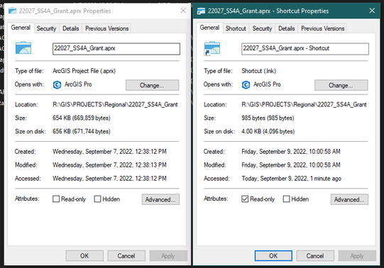

neat! I was hoping that copy > paste shortcut and setting the shortcut to read only would also do it, but this does not work. I guess 'read only' only refers to the shortcut, not the file it points to.
