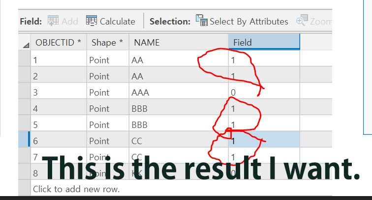

03-24-2021 04:28 AM
KalSsin
uniqueList = []
def isDuplicate(inValue):
  if inValue in uniqueList:
    return 1
  else:
    uniqueList.append(inValue)
    return 0
Hi~~~Please refer to the illustration.
Above coding to output 0 1.
I'd like to output 1 1.

KalSsin
DavidPike
MVP Notable Contributor
Are you saying the top picture is what you want - that makes sense to me - rather than the bottom picture?
looking at the code, I don't see how you got those results in the bottom picture either.  Did you try the code I suggested?
KalSsin
I used your code.
The picture below is the printout I want. I used your code.
I'd like to express all duplicate names by 1.

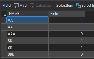

JakeSkinner
Esri Esteemed Contributor
It may be easier to do this with a script rather than the Field Calculator.  Ex:
import arcpy
table = r"C:\TEMP\PYTHON\Test.gdb\XY"
nameDict = {}
with arcpy.da.SearchCursor(table, ["NAME"]) as cursor:
     for row in cursor:
         if row[0] not in nameDict.keys():
             nameDict[row[0]] = 0
         else:
             nameDict[row[0]] = 1
del cursor
with arcpy.da.UpdateCursor(table, ["NAME", "Field"]) as cursor:
     for row in cursor:
         row[1] = nameDict[row[0]]
         cursor.updateRow(row)
del cursor
Result:
