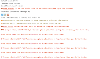

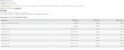

Thanks for the Blog. I am reasonably new to ML and have previously had some limited experience with RF. I have begun trialling the AutoML tool in Arc and have a number of questions I was hoping I might be able to get you to help me with.
  • When running the application with the 'Algorithms' section left blank the only alogrithm being used initally was a decision tree. When I tried manually selecting other models it would not process and give me an error (as seen in the below Grab 1). I think I have resolved this by increasing the time limit from the default 60 to 240, would this have been the issue? Now when I select all the algorithms, or leave the mode field blank, a Decision Tree and a Light GBM algorithm are used (As seen below in Grab 2). Is this still ignoring the other model types? I also note that in my example multiple decision trees are being used (See Grab 2). Are these just Decision Trees with different hyperparameters?

1. If you leave the algorithm feild blank, then the tool will try to fit all available models on your data. However, if some of the model training fails during the process then that model is ignored and the tool proceeds to fit the next model on your data. In your case it looks like the a decision tree and a LightGBM models were trained and the other models couldnt be fitted.
Second part of the first question - Yes. These are different variations of decision tree with different hyperparameters and different variable combinations.

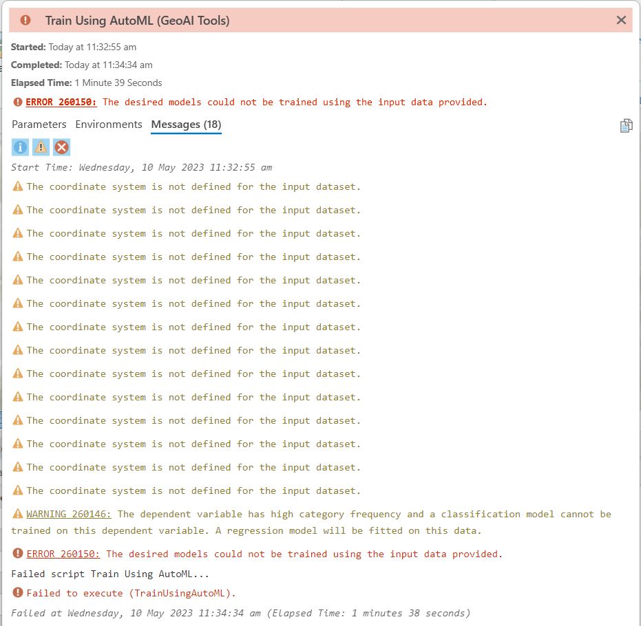

 I am running the Train using AutoML tool in ArcGIS Pro, it works in my PC (version 3.0) but in my laptop with ArcGIS Pro 3.1, it's not working, although I used the same dataset. I have attached the problem here. Can you please let me know how to fix this? Many thanks

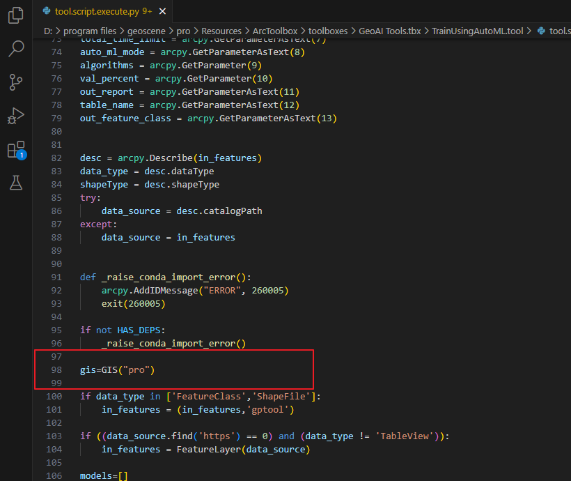

I would like to report one possible bug, when I am using the AutoML tool in a disconnected environment or when current portal is set to a portal with self-signed certificate, the tool will return error messages.
Upon checking the source code, I noticed it trying to connect to the portal, can you explain why this is necessary? Becuase I didn't see any parameters in the tool that related to the portal.
