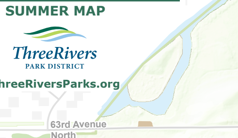

I think I've identified a work around for your issue.  Using your park basemap and hillshade layers, you can select the hillshade layer, go to symbology, select the "Mask" tab, and then change Nodata to be white.  That should allow it to export to PDF without those grey edges. The attached screen shot was of the exported PDF opened in Google Chrome.  Let me know if that doesn't help on your end and I can double check the export settings I used.

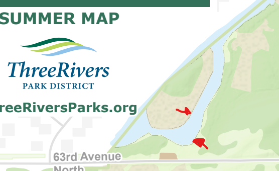

We were already using the Mask setting in symbology with NoData being set to no color(so not being colored), but I did mess with setting it to a color but as you can see in the attached image everything besides the raster is considered NoData so it is not going to work for us with blend mode etc.

Set noData to white and do the multiply blend mode - white is treated as "1" so it doesn't have any impact in the multiply blend mode.
Also, I applied the "Multiply" to the hillshade layer so it's multiplied with the basemap. Using a grey color scale and noData set to white, it should apply as if it is a complete raster.

Oh yep you are right, that fixed it. I'll mark your original reply as the solution. I had hesitated earlier because when I first set it to white Pro showed essentially the whole area as white. The second time I tried it, Pro showed it as you described as did the PDF.
