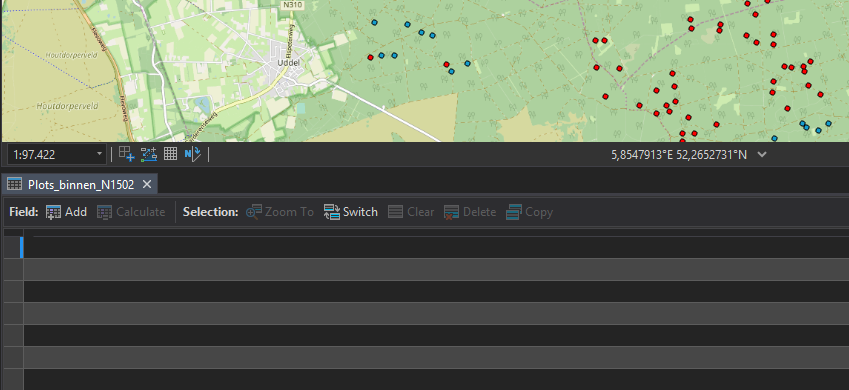

I loaded a point feature layer with 178 records in arcgis pro 2.5. Everything is showing in the map as expected. But my attribute table is not showing:
the switch button switches the selected rows but shows nothing. The Fields View button results in
