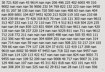

Is it possible to do this in the map layout using dynamic text? I would like to display the sum of all line segments in a specified feature class. Here's a screen capture of what I have tried but the output is a list of values, not a total sum.

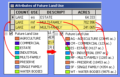

I have a similar question. How do I automate this in ArcPRO? AdvLegSymLabelIntroduction.gif
