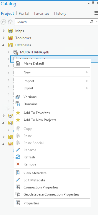

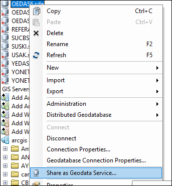

Hi,
Is there anyone before try to share geodata service in ARGIS PRO like we use button "Share as Geodata Service..." in Arcmap?
I searched for documents about this. But it always led me to Arcmap.
Is there anyone know how to share geodatabase in Arcgis server by using Arcgis Pro?

This is a good question. Right now, it doesn't seem like sharing a geodata service with ArcGIS Pro is an option.
What is the intended purpose for the geodata service?
I primarily see geodata services used for replication.
However, replica workflows like "Create Replica" and "Synchronize Changes" are not available with ArcGIS Pro.
