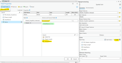

Then you should be able to do a spatial join as the ArcMap documentation mentions - just instead of having the "Merge rule" settings, you'll just select "Concatenate" for your new field and choose what delimiter you'd like to separate the input values. You'll also want to select the street name field to sort out the field mapping on this page. Hopefully, this screenshot of my settings should help you (I've used that "Add Empty Field" option to add in the "Name" field):
