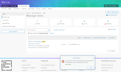

Today, I bought the ArcGis Pro for single user. Download was successful. But I got stopped by the issue of having a public account. If followed the links provided in these forums:
https://community.esri.com/t5/my-esri-blog/tips-tricks-arcgis-pro-and-public-accounts/ba-p/888451

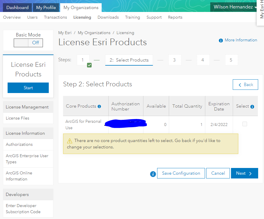

However, the problem persists. When I sign in as, I presume, the administrator the only one license is already taken for somethig I did previously. There is no possibility to obtain a licence file:

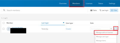

Once activated, login to https://arcgis.com from browser. Navigate to Organization > Members > options icon (...) > Manage Add-on Licenses
Select ArcGIS Pro and its extensions for assigning to the named user.

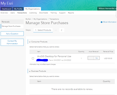

But I keep finding problems. Indeed, the product is not activated as you said. However, when I follow your route, no options on "product information" are presented:
When I click on the info of the item, it takes me to a "View Summary and Modify Quantities" tab with no activation procedure.

But two problems persist:
1. I do not see the route: Organization > Members > options icon (...) > Manage Add-on Licenses (bakground of the image)
2. I still get the problem of public account (though I followed the suggested steps).

If you have setup your organization in ArcGIS Online (www.arcgis.com), Login to https://arcgis.com using the credentials you used to activate your ArcGIS Online. It will redirect to your organizational account page. There you will see Organization > Members > options icon (...) > Manage Add-on Licenses.
