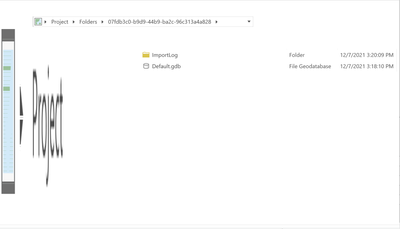

Hi all,
I am a student at Northeastern University - I am having some problems trying to use ArcGIS Pro, I've attached a video of what is happening. I had no luck with the Northeastern IT Department and the ArcGIS Technical Support folks referred me here.

Sorry, it says it's still being processed. I guess explaining it step by step might help in the meantime. It's basically the first few steps of the homework assignment I've been given.
Step 1. I open ArcGIS and start without a template.
Step 2. go to Catalog > Folders > Add Folder Connection (connecting to the data for the homework)
Step 3. In the geodatabase of that added folder connection, there's a point shape file, I add that to a new map
Step 4. Analysis Tab> Model Builder > Iterators > Iterate Feature Classes
Step 5:  Click on the hexagon for Iterate Feature Classes, then the folder next to workspace or data feature set
Then it looks like this....And when I scroll over the icons, they disappear.

Sounds like a bug.  Try repairing ArcGIS Pro.  Also make sure you have all the required clients and drivers necessary to run ArcGIS Pro.

Uninstalling alienware (per that link) did the trick!
