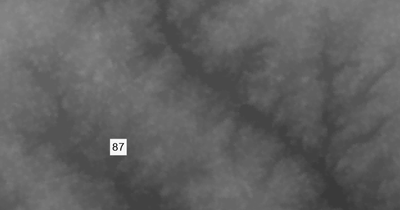

That rings a bell now.  Be nice if there were something like QGIS Value Tool where as the mouse moves, the value is displayed.  Dang.  Thanks @jcarlson

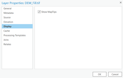

You can enable Map Tips for the Raster layer (Layer Properties > Display).
*Sorry. The mouse cursor isn't visible while taking a print-screen.😅
