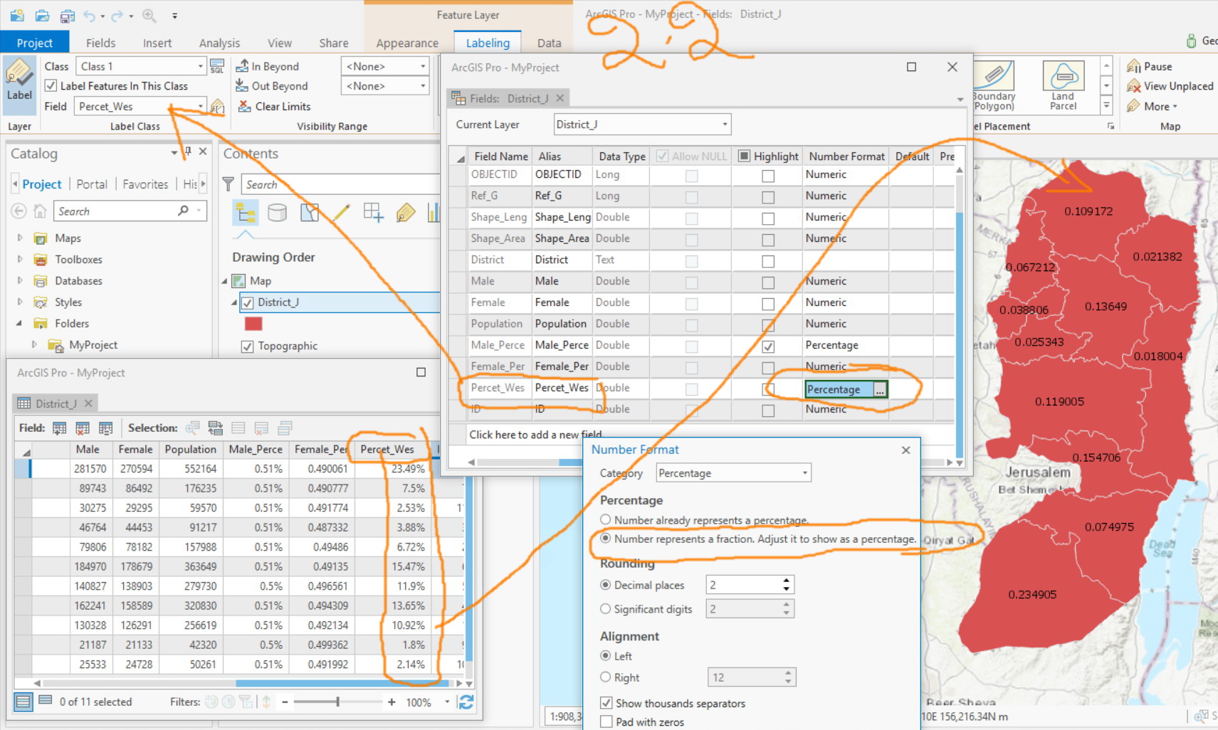

I couldn’t figure out why ArcGIS Pro doesn’t label values (attached) as they appear in the table.
What could be the issue here?

Jamal - so I think your numeric field is based upon a DOUBLE.  What you see in the attribute table is numeric formatting of the DOUBLE but your label shows the unformatted number.  What you can do is build an Arcade expression such as:
round(number($feature.Percet_WestBank * 100), 2) + "%"

Are you using the Arcade label expression parser?  Please see this help topic - Specify text for labels—ArcGIS Pro | ArcGIS Desktop
When using Arcade, field formatting on the layer will not be brought over to the labels. Arcade formatting methods will need to be used.
To bring across the field formatting you will either need to use the Arcade formatting methods, or use a different expression parser for your labels.

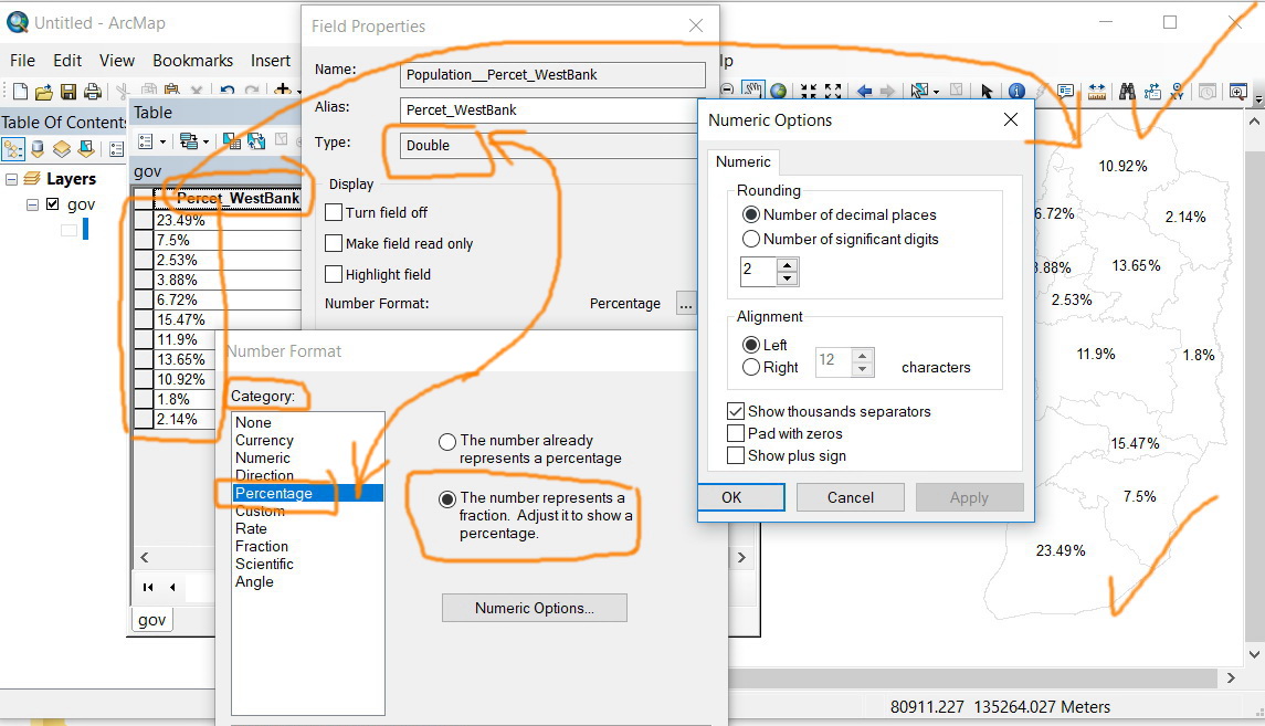

This works fine in ArcMap.
Having the “type” to be “double” and “category” as “percentage” works perfectly without the need to write any code. Simple. The data is attached

This never works, Hanna.
The issue here that the percent sign does appear at the level of table but fails to do so when labeling them as shown in the screenshot below. This has been an easy and straightforward task in ArcMap
