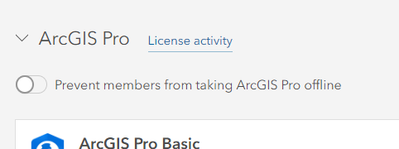

1) This may be disabled in your ArcGIS Online. If you have permission, go to Organization --> Licenses --> Add-on license and make sure "Prevent memebers from taking ArcGIS Pro offline" is not switched on:
