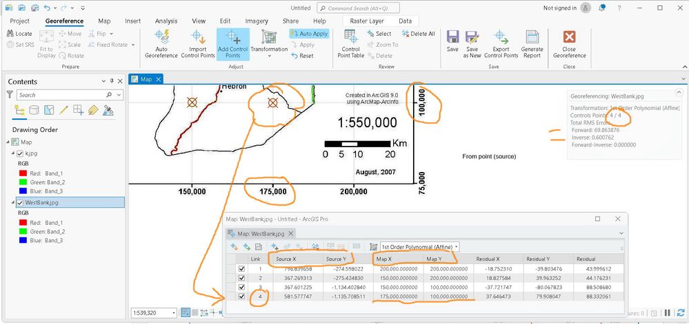

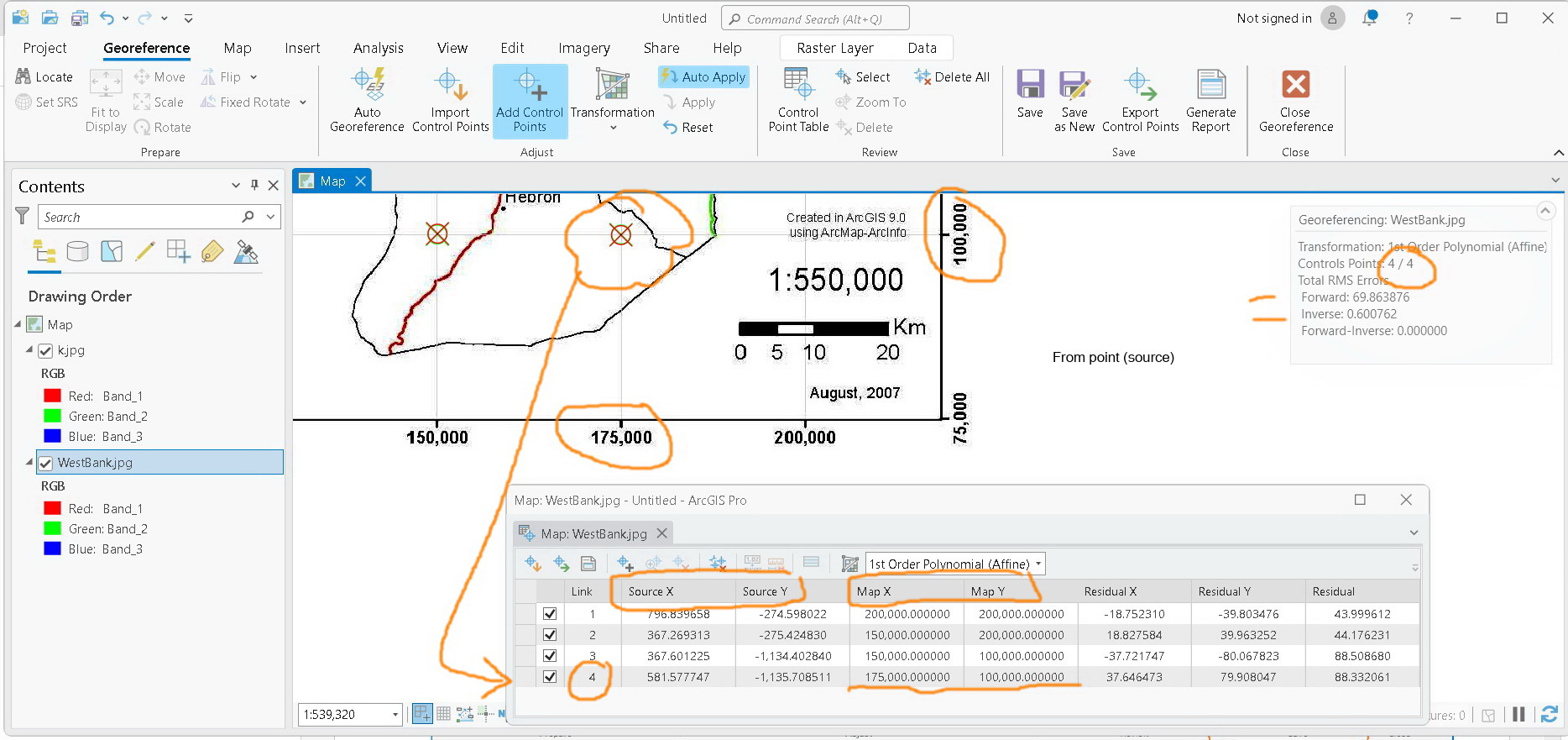

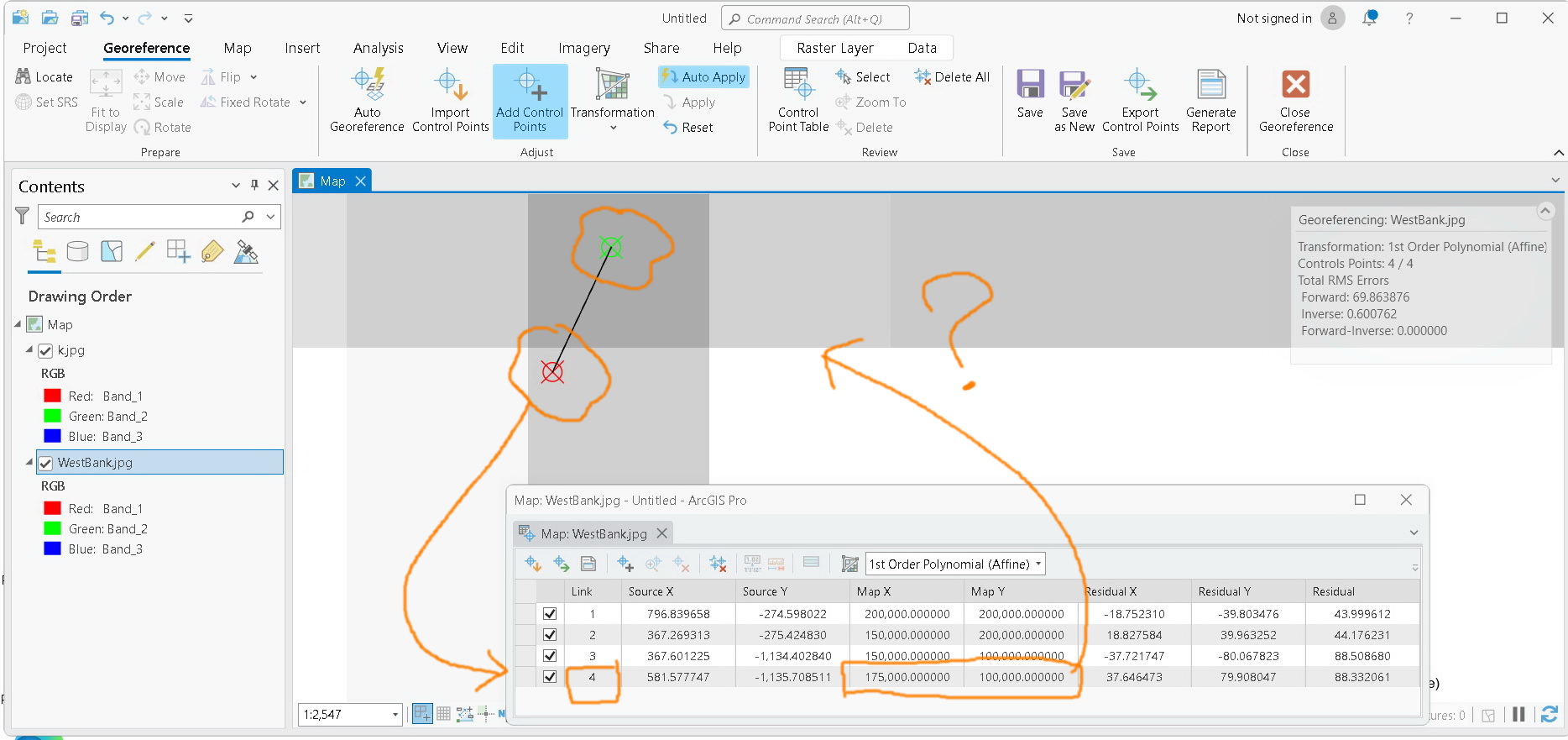

For example, in the screenshot below, point #4 is georeferenced to the target coordinates. Zooming in reveals two points: one red and one green. What do they indicate?

The red and green markers represent From and To locations when you georeference a raster layer to a referenced layer.
See the following video clip that illustrates the process beautifully: Georeferencing in ArcGIS Pro in 5 Minutes: Rubbersheeting
The documentation page for Pro 3.1 is Georeference a raster to a referenced layer.

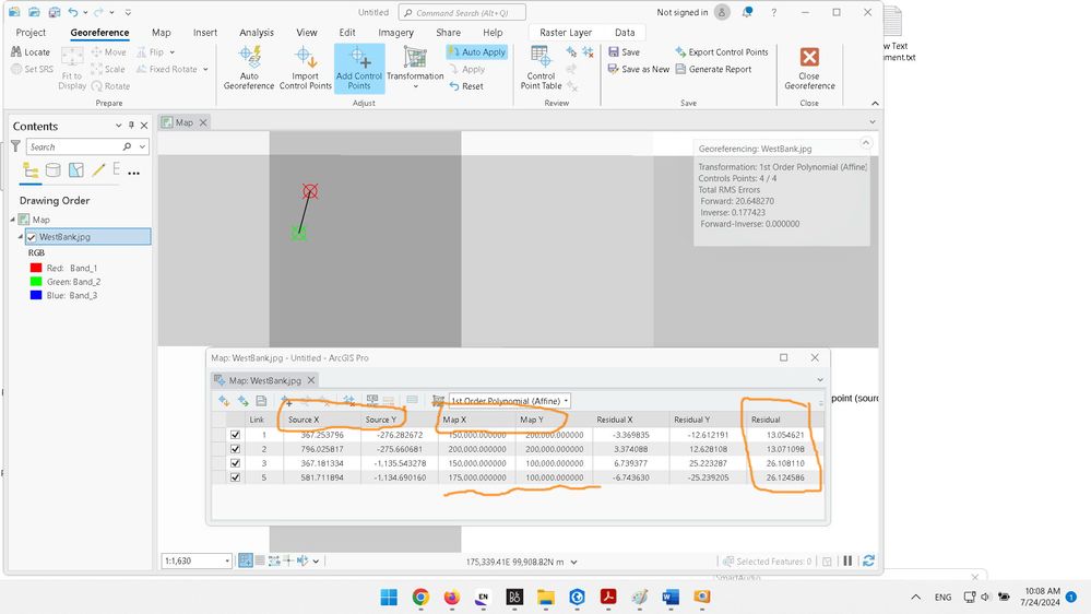

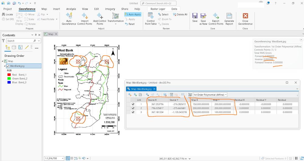

This is still not clear.
What do you mean by “From” “TO” Locations? What does this mean in terms of the Source and Map coordinates shown in the second screenshot?
Why the green points appears only after adding the fourth point?
How the Pro determines the location of the green points?
