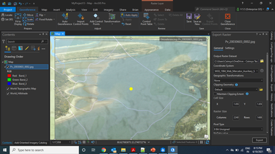

I've seen a few similar posts to this issue but mine is a little different and none of the work arounds I've seen have worked for me.
I have many aerial photos (.jpg) with accompanying world files (.jgw) based on the plane's GPS coordinates that I'd like to add to a map and then subsequently move around (georeference) to new locations. No control points are involved--they are oblique images and I'm not overly concern about their true location (relative is good enough).
Here are the steps I'm using:
I open a new project and set the map coordinate system to "WGS 84" to match the world file. Then I "Add Data" to select an image. At this stage I've done this 1) with and without building pyramids, 2) with and without calculating statistics, and 3) with and without the checkbox in the raster options where it says "Use world file to define coordinates to the raster".
Next I select the image in the "Contents" pane and then select the "Imagery" tab.
Then I select the "Georeference" tab and then the "Move" icon. I then move the image to a new location, select "Save", and then "Close Georeference".
At this point, as soon as I hit close the image disappears!!
If I "Zoom to layer" on the image the map shifts to the new location but nothing is visible. However, if I repeat the above Georeference steps (i.e., move, save, close) on the same (or another image) one or sometimes two more times then the image finally appears in its new location and I can move on. But this is time consuming and cumbersome as I have hundreds of images to process like this. I had the same workflow in ArcMap for years and it worked quickly and perfectly there.
I've attached a sample picture and .jgw file if you want to try it yourself. The .jgw extention is renamed to .txt in order to upload--just change it back. Also I realize the image is over land and the .jgw puts it over water--it's just a fake example. Thanks for any suggestions!
