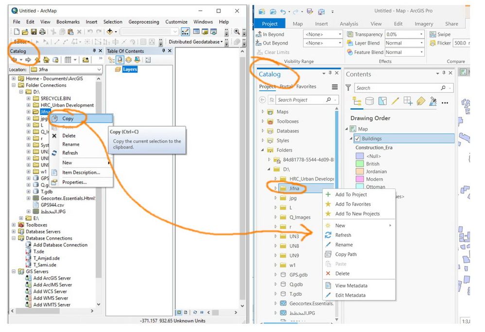

I couldn’t figure out how to copy folder in catalog. This option is used to be in ArcMap as per the screenshot below

Copy and move items—ArcGIS Pro | Documentation is the recommended procedures.  Perhaps too many problems with shortcuts being used, it was removed.  Rename, New, Refresh and Copy Path are relatively save.  Paste is there when copied properly

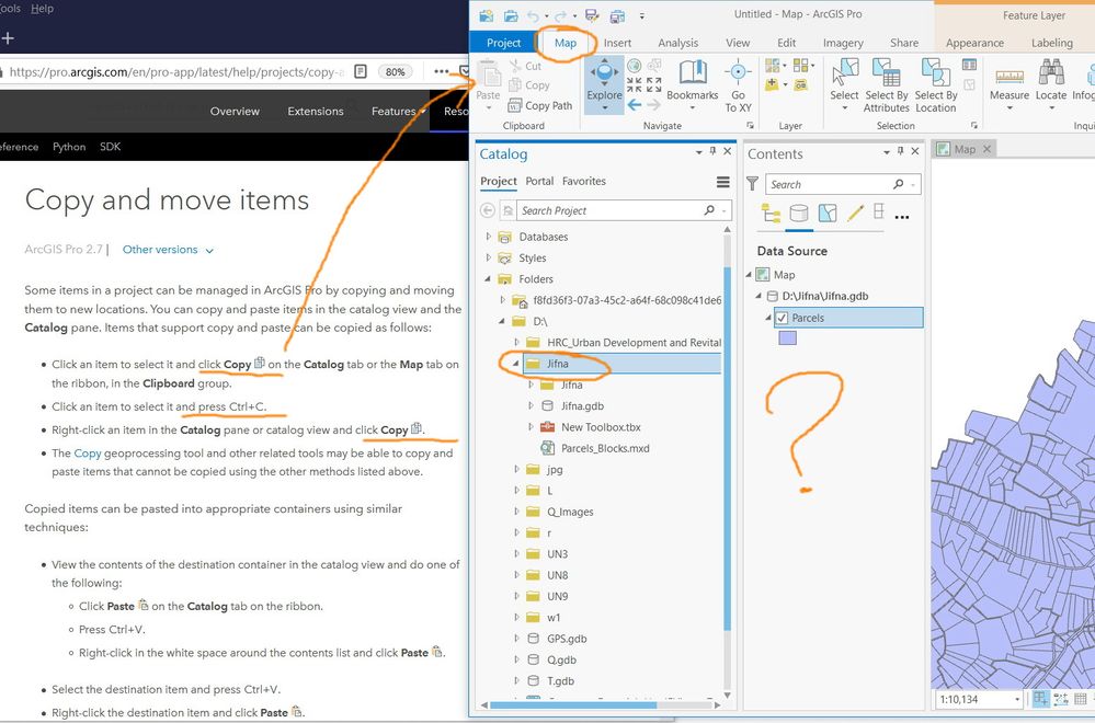

Appears not to work with me as per the screenshot below

In the current ArcGIS Pro (2.7.3), there is no way to do this.  There is an idea that's marked Under Consideration that you can upvote.  I suspect this will be available in a future release of ArcGIS Pro.
