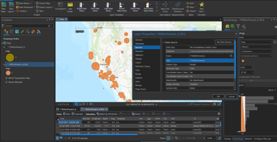

Could you share screenshot of the layer, in case the issue still persists?

The problem is persisting. Yes I am logged into my school's organizational account. I tried sharing a different layer and it worked no problem, but this layer is still greyed out when I try to share as web layer. What aspect of the layer would be most helpful to screenshot?
About to check out the link the other user posted.
