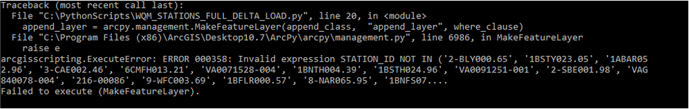

 Awesome and elegant solution! I'm trying to use this script to achieve a similar delta load between two feature classes but I'm running into an error I can't seem to get past. Regardless of how I try to structure the WHERE clause...arcpy continues to throw the 000358 error code indicating something isn't right with the SQL syntax. I'm printing out the (large) where clause (I have about 18k unique STATION_IDs that it's parsing through)...but everything looks find from a syntax perspective.  After two days of testing/tweaking...I'm about to give up. Do you see anything amiss here? For development, both feature classes are local in a file geodatabase. I've tested in Python 3.x and 2.x and receive the same error in either environment.

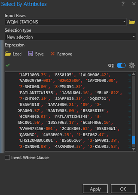

Yeah, it's your id values. Some of them contain apostrophes/single quotes. These characters are used in SQL to denote string values, so the where clause got corrupted.
For example, in this part, it recognizes the commas as string values and everything you actually want to select as mumbo jumbo:
(for the record, putting the where clause in there froze my PC for over 5 minutes. Can't imagine why, it's only 404.000 characters long :D)
Well, turns out there is only one id with an apostrophe:
[i for i in existing_ids if "'" in i]
["YOUNG'S POND"]
So either fix that id or make the code safer. Online search suggests that to escape a single quote in SQL, you just put another single quote in front of it.
