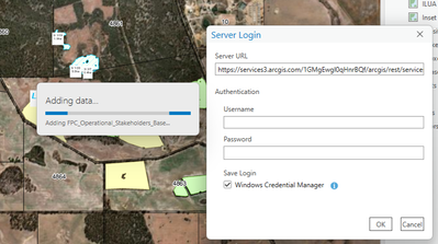

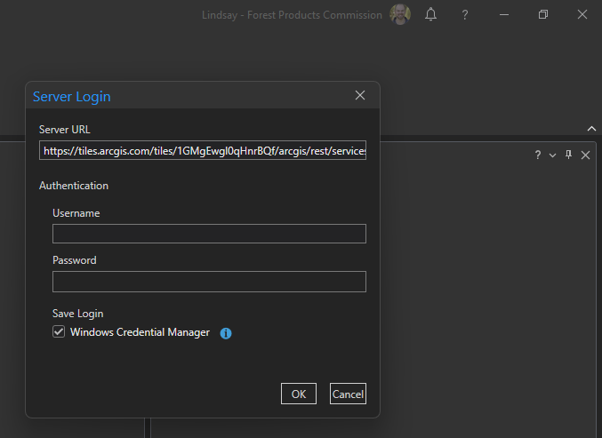

When opening ArcGIS Pro with one of our organisational feature services or tile services, we "sometimes" get the below looking window appearing. You can't actually login through it (won't recognise our ArcGIS Online user credentials) and when you click Cancel, it loads the project with our custom basemap layers in ArcGIS Online sources broken whilst other feature services are ok.
We are logged in to ArcGIS Online through ArcGIS Pro already and still are despite clicking Cancel, so not sure whats going on (as you can see at the top of the screenshot).

Hi @LindsayRaabe_FPCWA
This looks like you have added a service at one stage, like an OGC service.
Please see the following documentation for the following information
Connect to a GIS server
You should be able to hit the x button or cancel this window and use Pro as expected, however, if you have this service in a project or require it you will need credentials to access it. If you don't need it you can open the catalog pane, drop down the Servers folder and remove the connection wherever the connection is held.

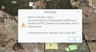

I've had a closer look - it's not an OGC or other added service. It's definitely related to our ArcGIS Online content. The below screenshot captures the window coming up as we try to add a feature service from our AGOL environment, and when we click Cancel (because entering credentials does nothing) we get the layers added to the map with broken sources and the following error.
