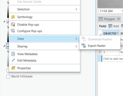

A second way of achieving this is to download data from Terrain layer in Living Atlas and then use Add Surface Information. Below an image of how you can export a raster from the terrain layer once you have it opened in Pro and right-clicked it in the contents layer.
