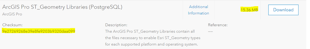

I feel, you just need to download the correct "st_geometry.so" file from MyEsri relevant for ArcGIS Pro 2.7.
Check the steps I listed in this post: Where can I find ST_Geometry for ArcGIS Pro 2.6 and Postgres v10.10 on Windows
