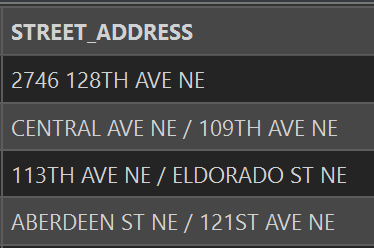

I'm trying to geocode a table in CSV format that contains simple addresses and intersections. Unfortunately, both types of data are failing to geocode properly. The dataset I'm working with has over 200,000 records, but the best match rate I've achieved so far is just 12%. ( I have tested manually looking up the unmatched ones and I am getting actual matches)

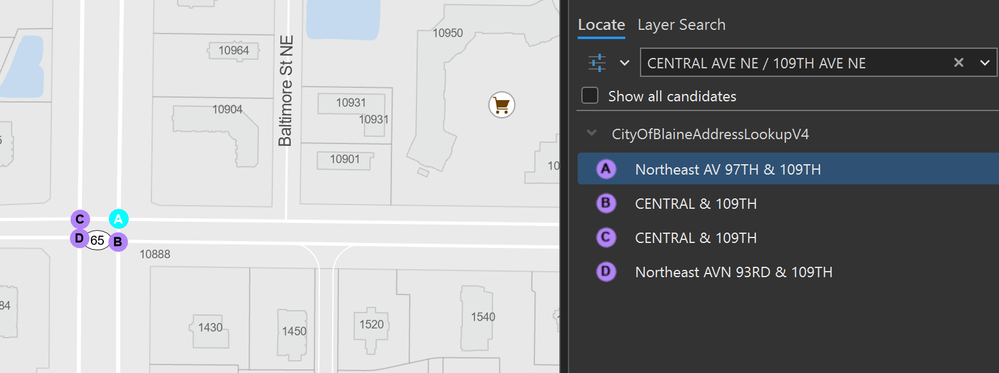

I've tested smaller datasets and noticed something odd. I understand that altering the format of the input data might change the results, but here's the strange part: when an address fails to match during batch geocoding, I can copy and paste that exact same address into the Locate tool, and it pops up immediately without any format changes or edits. But when processed in a batch, it returns a 0 match score.

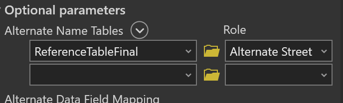

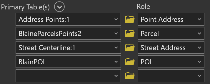

@Roger_Schulz Can you provide screenshots of the Reference data section for each role in the multirole locator as well as the alternate name table section and an example of the input address in the table you are batch geocoding? If after you geocode the table and you open the Rematch Addresses pane do you see candidates for the unmatched addresses? Which version of ArcGIS Pro are you using?

Below are some screen shots of the process. we can see how all the example data. (both intersections and address specific are yielding candidates and solutions manually using locate.
I have run the geocode table in many different ways, most common way is to right click, geocode table, and run the wizard.

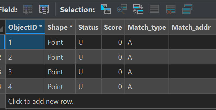

with these 4 points I got 0 matched and none have a score above 0.
The alternate table is for Alternate address and street post direction and type abbreviation corrections.

@Roger_Schulz Thanks for providing the screenshots of the Locate pane, do those same candidates show in the Rematch Addresses pane for this  intersection address?

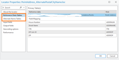

As for the locators, I was looking more for the following so that I can see the field mapping of each role and make sure things are linked correctly.

First, for the address in the locate pane (Central and 109th) there are 0 candidates in the rematch pane. There are no candidates for any un-matched address. It either matches with a 100 score or yields 0 candidates. It is quite odd.
Second, I double checked all my settings for roles, order of importance and field matching. All of my fields appear to be properly joined and build correctly. Thanks again for pointing out that spot for field mapping in the properties.

@Roger_Schulz In the field mapping of the roles do you have city, state, or zip mapped? From the results of the Locate pane it does not look like you do for StreetAddress role. When the locator does not have any zones (city , state, county, zip) , which are considered locations and you search for the address in the Locate pane the center of the map is used as the location and returns suggestions and find results. Batch geocoding doesn't have any awareness of location (city, state, zip, county...) , so it would need to be included in the table if the locator has zones in the field mapping.
