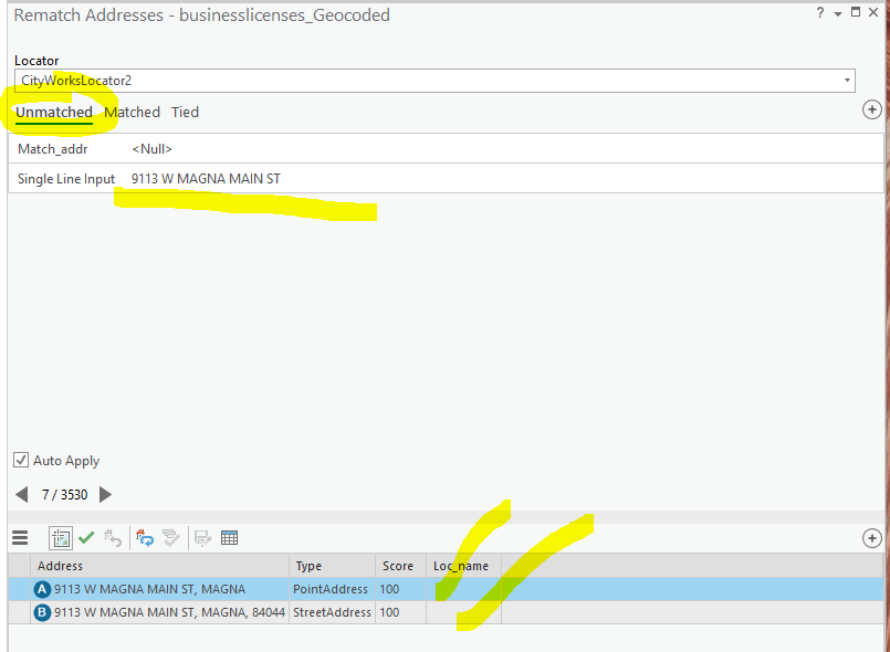

Using ArcGIS Pro 2.7.2 and a composite locator.
I'm seeing what I feel is odd behavior when geocoding. (See image below).  This address 9113 W MAGNA MAIN ST initially shows as unmatched, but there are two 100% match options available to me.  What's up with that?  I sure would hate to plow through 3500 'unmatched' records just to find out they really are valid...

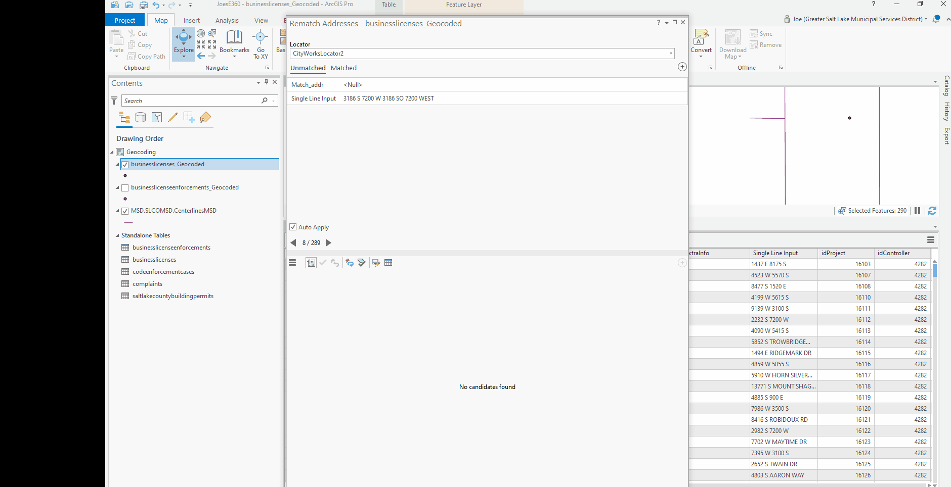

This problem I've mentioned in the past has reared it's ugly head again, where you adjust an address in the Single Line Input field, only to be bounced back to record #1.  The strangest thing about this is yesterday I didn't get this problem, and today, using the same locator but a different file of addresses I am...
and towards the end of the day...

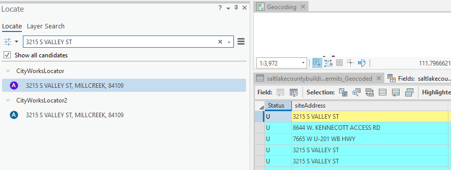

Notice  the address 3215 S Valley St went unmatched yet I can use the find tool with the locator I used (CityWorks2) and it hits on an address point...I have the locators set to Match With No Zones = YES....

I am unable to replicate the problem now.  The rematch process works just fine.  I cannot explain it but I did do a re-install of ArcGIS Pro 2.7.2 because I encountered some problems after installing 2.8.  Maybe I had a bad install?  Stranger things have happened.
Some good news though: I believe I have isolated the problem when rematching and it returns you to the first record after you make an edit to the Single Line Input  Just now I tried to rematch a selected set of records, and I was bounced back to #1 when  ever I made an edit.  If I clear the selection, I can adjust the Single Line Input and continue along.
The data I am trying to geocode has tons of records where the ADDRESS field is Null.  If I first geocode the entire table I get something like 3500 unmatched records.  I then select where ADDRESS is not Null and that leaves me with only 270 to rematch.  That's manageable, but not so much if I'm constantly getting bounced back to #1.

ShanaBritt
@JoeBorgione Just tying up ends here since you mentioned the jumping back to #1 in the Rematch Addresses Pane here, which is in our plans to address and can be tracked with BUG-000141513.
