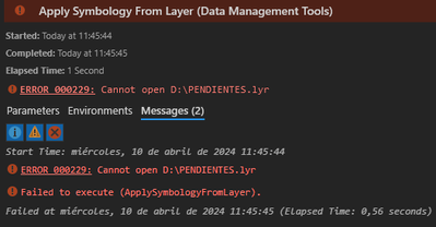

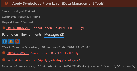

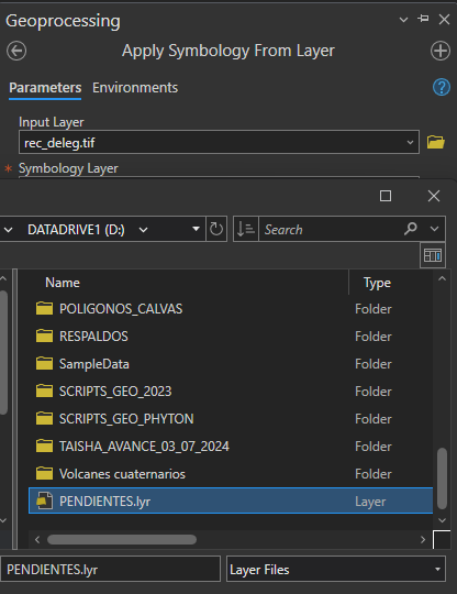

Hello everyone, I have a symbology layer that I used in ArcMap to set the symbology to the slope rasters, and I want to use the same symbology layer for the rasters in ArcGIS Pro 3.2.
It recognizes the file, but when I load it and click RUN, it gives me an error:
If you could help me, I would be very grateful.

The ArcGIS Pro application can read legacy . lyr file types, but it can only save to . lyrx file typesAs a workaround, I would try importing your ArcMap's MXD into ArcGIS Pro and export a .lyrx file from your raster. And this might be what you are trying yo do in this case.
