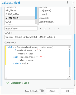

DavinWalker2
I hope the below helps.
This will replace the field I'm running the calculate field on with the value from the CODE field if the PLANT_ AREA field is not empty and replace it with the vale from field MEAN_AREA if it is empty.

DavinWalker2

DavinWalker2
You welcome.
