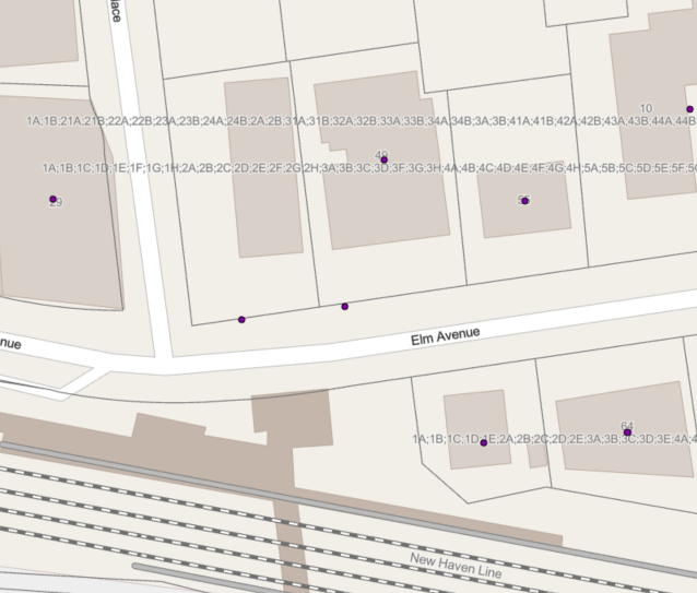

I'm running ArcGIS Pro 3.2. I have a  feature class of point data that was geocoded successfully, for the most part. Most of the points lie neatly inside building footprints. However, a significant number of the points lie outside tax parcel polygons. My client wants all the points to be inside the parcels. The parcels and the points have a common attribute.
Below is a screenshot:
Is there a way to place the points in the center of the tax parcels? I've tried joining by attributes, I've tried near, and nothing seems to do the trick.
I'm looking forward to any help!

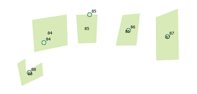

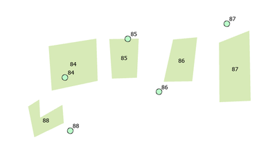

Before:
With do_all = False

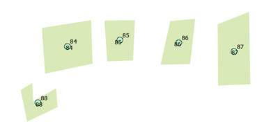

With do_all = True

Before:
With do_all = False
With do_all = True
