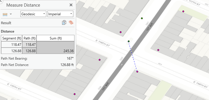

Hi all! I just updated to ArcGIS Pro for Desktop 3.0.0. I'm trying to do a spatial join between two point files, where I want to join all the points from file B that fall within a 200ft radius of the points in file A. I've chosen the same options that I would have from 2.3 but it's only returning a join of the closest point from file B (if it's within 200ft). Am I doing something incorrectly or is this a strange bug? Thanks!
(showing a point from file A in green that should be linked to four points from file B in pink)

If you have indeed done everything correctly and it's still not working as you'd expect, it could be a coordinate system thing.  Your measure tool is giving geodesic distance, but your relationship in the tool is Within a Distance.  You should use Within a Distance Geodesic so it's apples to apples.

It's good that the coordinate system of both layers match, but what I was getting at is that your spatial join currently is computing the planar distance between the two layers' features in their coordinate systems, but you showed you used the measure tool on the map.  That tool doesn't care about the layers' coordinate systems, it only cares about the map's.  Which may very well be the same as your layers, idk.
But you have to be careful because suppose you're measuring the planar distance between two points in Greenland, using a web Mercator projection.  Your measurement will be horribly distorted.  Pretty much everywhere you should use a geodesic measurement unless your coordinate system is already highly accurate, like a US State Plane projection.  You can Google "planar vs geodesic distance" and you'll find a much clearer answer about that.  But as a general rule of thumb, you can think of geodesic as always the correct distance, and planar as sometimes the correct distance.
