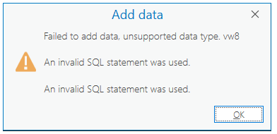

I just tried your example on Pro 3.0.3, and I get "An invalid SQL statement was used" error.  I am able to create the tables and create the view, but I can't add it to a map.  Are you able to script out your steps so I can try running the code exactly the same way because something in our workflows is obviously different if it works for you but I get an error.

It seems there is a bug in ArcGIS Pro 3.0.3.
I tried to repeat my steps, but I got the same error you did when adding the view to the map:
Failed to add data, unsupported data type.
An invalid SQL statement was used.
Workaround:
Create the tables in a FGDB, but then copy the tables to a new FGDB (using right-click copy/paste in Catalog). In the new FGDB, I'm able to create the view, add the view to the map, and open the attribute table.
Does that workaround work for you?
Note: The bug doesn't appear to be specific to the INNER JOIN view we're testing. I got the same error when creating a simpler view:
select
from
    table_a
Related: Bug: View on FGDB standalone table — can't add view to map
