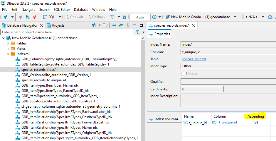

For what it's worth, adding an attribute index to a field in a mobile geodatabase table seems to sort the rows descending. (However, if the index is deleted, then the data seems to revert back to its original order.)
(I'm not used to seeing the actual data being sorted due to an index, since I normally make indexes using Oracle data. If I understand correctly, ascending or descending doesn't matter for Oracle indexes, except for composite indexes.)
I left the Ascending checkbox blank when creating that index.
I wonder why it sorted the data descending, despite the index being sorted ascending, as shown in a SQL client:

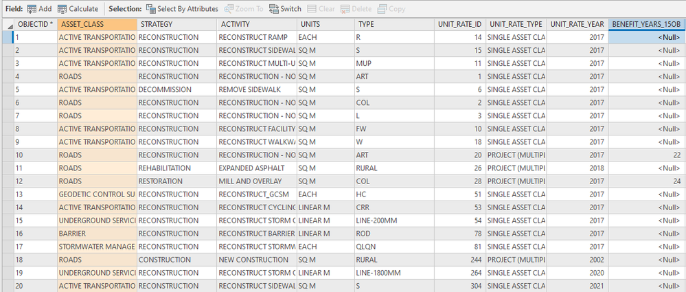

I have a small UNIT_RATE table that users edit once per year.
When looking at the attribute table, the data doesn't make much sense when it's unsorted:

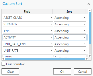

It only makes sense when it's sorted into groups. The user would navigate to a specific group and add an entry for the current year.
Sort into groups using a custom sort:

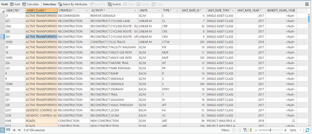

Now the data makes more sense:
When users go to edit the table each year, it's unrealistic to get them to do the custom sort in the attribute table each time. They just don't remember, get confused when they look at the data, and end up botching their edits.
I'd rather sort the table permanently myself, once per year, prior to the year-end edits. Either manually or on a schedule.
