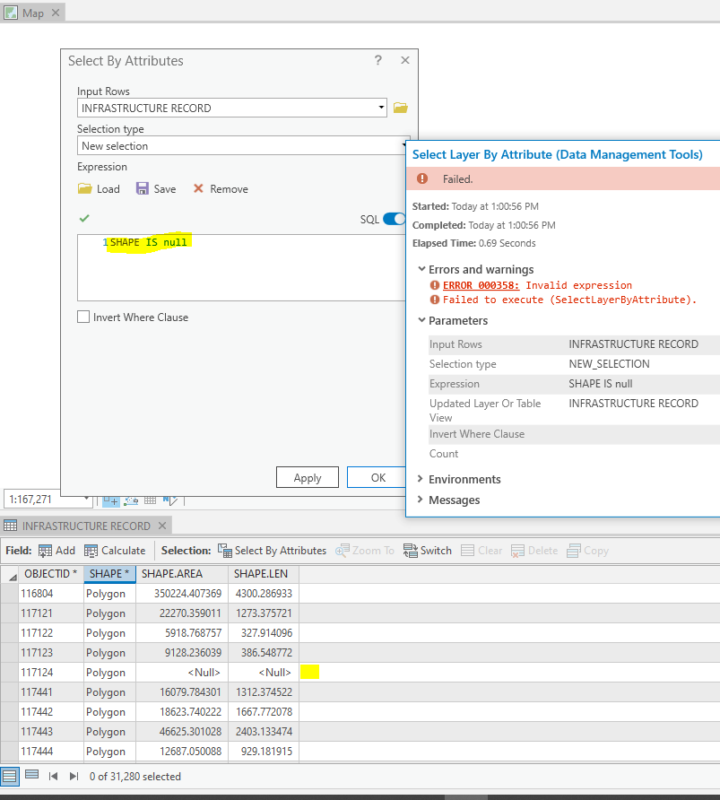

As far as I can tell, it isn't possible to Select By Attributes using a SQL expression that references the SHAPE column:
Whereas, it is possible to do it in a definition query.
That seems like an oversight. We should be able to query the SHAPE column, such as WHERE SHAPE IS NULL. And more complex use cases.

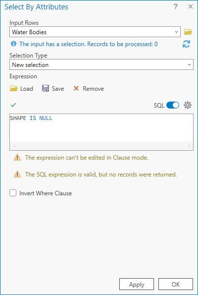

I'm using ArcGIS Pro. 3.2.x and in the Select by Attributes GP window, you do not see the SHAPE field to build a query via the Clause Builder.  But if you switch it to the SQL Builder, you can create a query here.  So I wonder if it's a ArcGIS Pro version issue and/or a DB issue.
See image below.

Bud
I think the problem might be specific to versioning. I created a copy FC that isn't versioned and Select By Attributes worked on it without issue. If I register as versioned, then I get the error.
For what it's worth, SHAPE IS NULL works in definition queries, regardless if the FC is versioned or not. So that makes me think there is a bug specifically with Select By Attributes.
