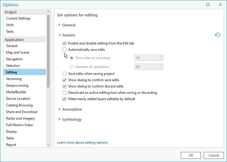

@LarryYoung.  I have installed 3.1 and I don't see this long-needed ArcMap equivalence feature.  Please give us an update.  Did it make it into 3.1?
I checked my Options > Edit settings and I have everything set to not save edits automatically.  Nevertheless, when I made an edit it was saved automatically when I exited the record.  3.2 then?
