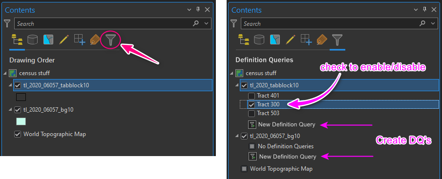

Another idea is to have a tab in the TOC to view/manage Definition Queries, much like how Labeling has it's own tab, and the labeling pane handles display filters:
This way, chips won't mess up the Layers tab, it's out of the way if you don't want to look at it, but it's there if you need it.
