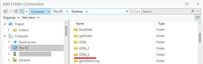

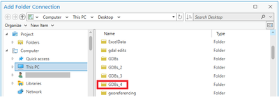

Steps:
1. ArcGIS Pro is open.
2. In Windows Explorer, create a new folder on my Desktop called GDBs_4.

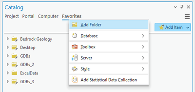

3. In ArcGIS Pro, go to Catalog —> Favorites.
4. Click the Add Item button —> Add Folder.
5. Problem: I don't see the new GDBs_4 folder in the list of folders on my Desktop:
6. I tried Catalog —> Favorites —> hamburger menu —> Refresh.
7. The refresh has no effect. The folder still isn't shown on my Desktop.
8. Solution: As a last resort, close and re-open ArcGIS Pro.
9. Now, I can see the new folder in Catalog —> Favorites —> Add Item button —> Add Folder:

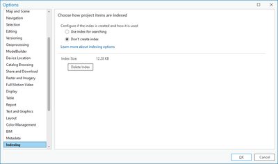

Bud
Thanks @ChristopherCounsell.
For what it's worth, indexing is disabled in Pro on my computer (and was disabled when this test was done).

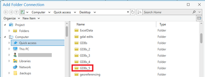

Bud
I added an additional new folder. To my surprise, the Add Folder dialog did show the new folder this time (without needing to click the refresh button that you described in the dialog). So that's a head scratcher. Why did it automatically refresh this time?
