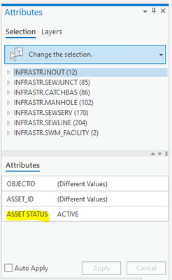

Use case:
Easily update multiple FCs to ASSET_STATUS=ACTIVE if assets overlap a specific subdivision polygon.
Workflow:
Use Select By Attributes to select features in multiple FCs that intersect a subdivision polygon.
(view in My Videos)
Then, update the selected features to ASSET_STATUS=ACTIVE.
All the FCs have the same ASSET_STATUS field. But as far as I can tell, there isn't a way to select multiple FCs in the Attribute Pane and then update the field to ACTIVE for all the FCs using a single action.
Instead, I'd need to manually update the field in each FC, one FC at a time. That's ok if there are only a couple of FCs, but if there are dozens of FCs, then that takes too much time — especially if there are lots of fields in the FC, so the user needs to navigate to the bottom of the field list each time.
Could functionality be added to the Attributes Pane (or elsewhere in the UI) that would let us update a common field in multiple FCs using a single action?

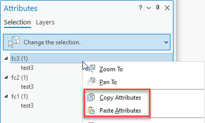

I know you mentioned having a dedicated way to do this in the UI, and that's a good suggestion. Until something like this is available, some suggestions:
Within the Attributes Pane , you can Copy and Paste Attributes. If you want to ensure only specific attributes that match are pasted, you need to set up Field Mapping in Editor Settings.

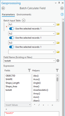

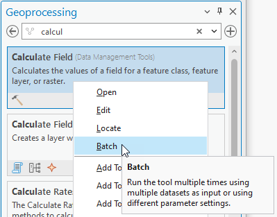

Another, possibly faster way (without having to build a script or model) is to use the Calculate Field tool in Batch mode.
Bud
Thanks @Scott_Harris. That helps.

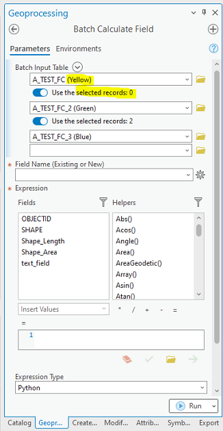

One benefit of the Attributes Pane is that it only uses selected features. That reduces risk; a user can't accidentally update all features in a FC, unless all features are selected.
Whereas I'd be worried about using a batch field calculation, since the calculation would be applied to an entire FC if there isn't a selection.

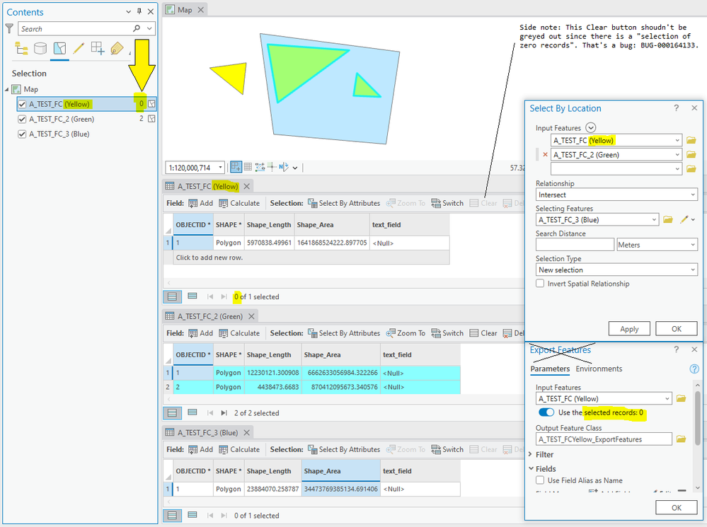

Edit:
But I suppose tools like Select By Location (UI) create "selections with zero records" instead of "no selection". So maybe that reduces some of the risk. A batch field calculation would be done on a "selection of zero records" for a given FC, which would be fine since no features would be updated.
See the yellow arrow for "selection of zero records" (ArcGIS Pro 3.2.2):
And the Batch Field Calculator tool does indicate if each FC has a selection or not. So That's good.
But I still think the idea is valid: Attributes Pane — Update common field in multiple FCs using single action.
Related:
  • Esri Case 03514864 - Selection of zero records: Clear selection button in Attribute Table is unavailable
  • BUG-000164132: The 'Clear' button under the Contents pane selection tab is missing when selecting zero records in ArcGIS Pro
  • BUG-000164133: The clear button is grayed out when selecting zero records and ensure consistent behavior for the clear button in ArcGIS Pro
  • Indicate in the map that a "selection of zero records" is applied
