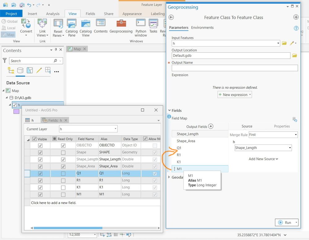

ArcGIS Pro 2.6: How to enhance the “feature class to feature class” tool to be able to keep reordering the fields in the output feature,

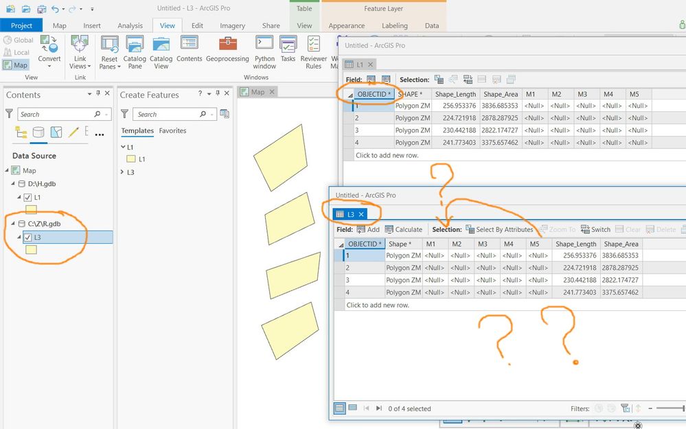

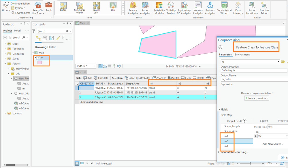

It would be great if the “feature class to feature class” tool is enhanced to to be able to keep reordering the fields in the output feature.
Currently, the output doesn’t respect in case the fields are reordered in the tool
In the screenshot below, F3 field is moved to be to the left of F1. As the tool is run, the output keeps the fields in their original positions!

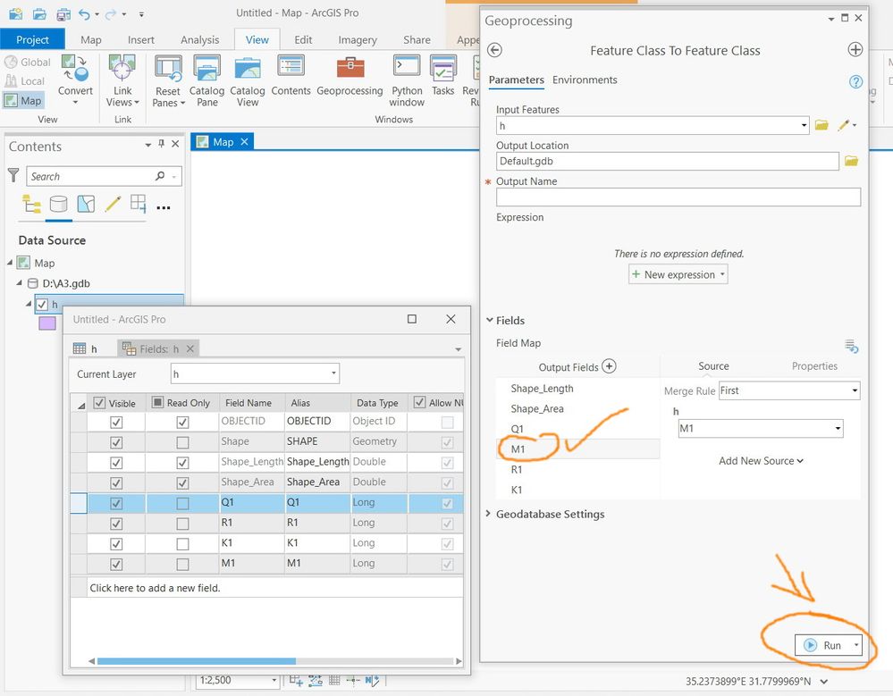

JamalNUMAN

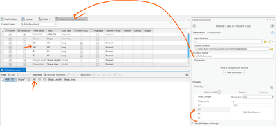

The issue persists to exists as per the screenshots below. It appears that no enhancement on this

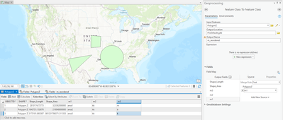

KoryKramer
Hi Jamal,
I can see from your screenshots that the field is not reordered as expected.  I tried again just now in ArcGIS Pro 2.7 and I see the tool working as expected:
So we're obviously missing something important that is needed to reproduce the issue.  As I said in my comment on Wednesday, this should not be treated as an idea, rather an issue that needs to be worked on with technical support to figure out how to reproduce the behavior you're demonstrating in your screenshots.
Thank you.

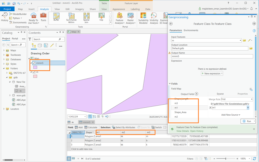

MajdoleenO_A__Awadallah

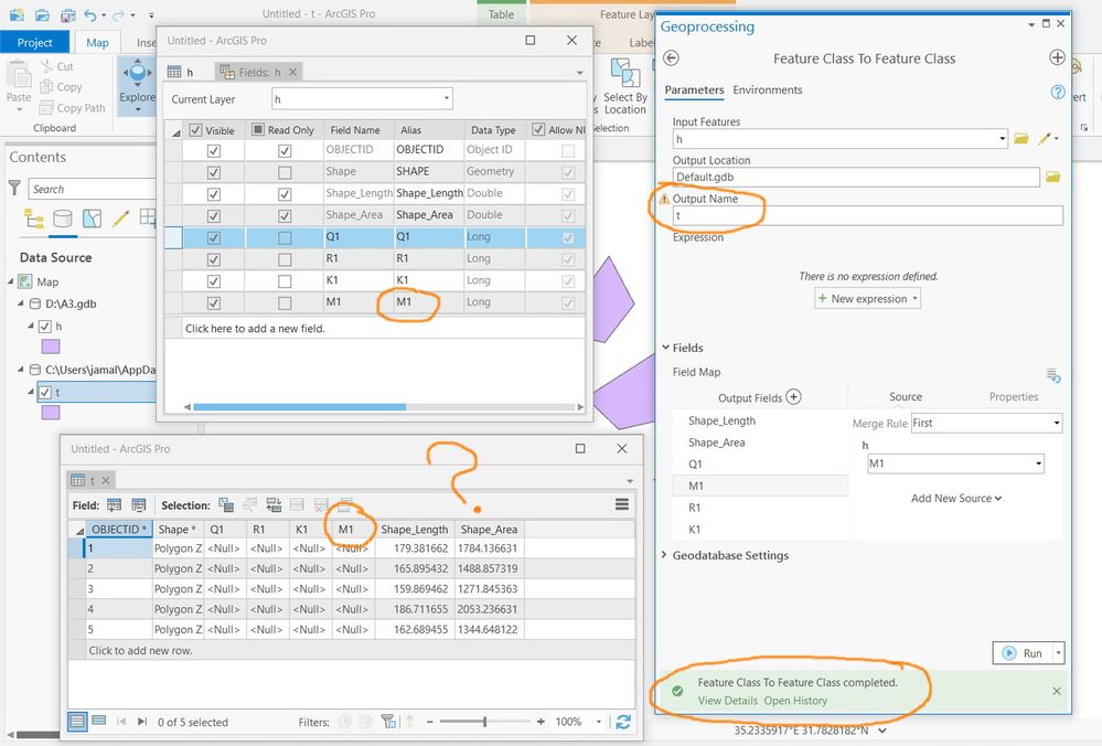

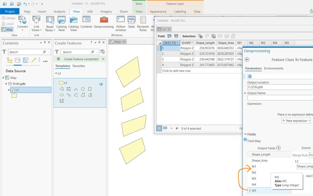

Hi @KoryKramer ,
Unfortunately, I end with the same behavior as @JamalNUMAN , it seems that their is a bug in this tool and I am using arcpro 2.7.

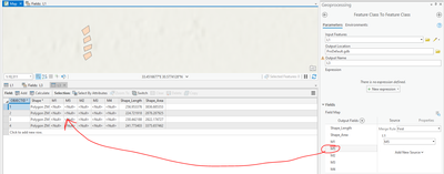

Unfortunately I don't think that your screenshots get us any closer to figuring out how to reproduce what you and Jamal are seeing.  I saw that you were using a polygonZ feature class and that Jamal was as well in his screenshots.  So I tried to reproduce (again!) but this time with a polygonZ feature class.  You can see that my original feature class has fields m1, m2 and m3 - I'm trying to replicate what I can from your screenshots.
See in the tool's Field Map that I reordered those to m3, m2, m1.
With the exception of the Shape_Length and Shape_Area fields moving to the end, I see that the field order set in the tool is respected.
Since both you and Jamal are experiencing an issue where it appears that the output order does not respect the order you set in the tool, please contact technical support to report this as a bug, with specific steps to reproduce the issue.

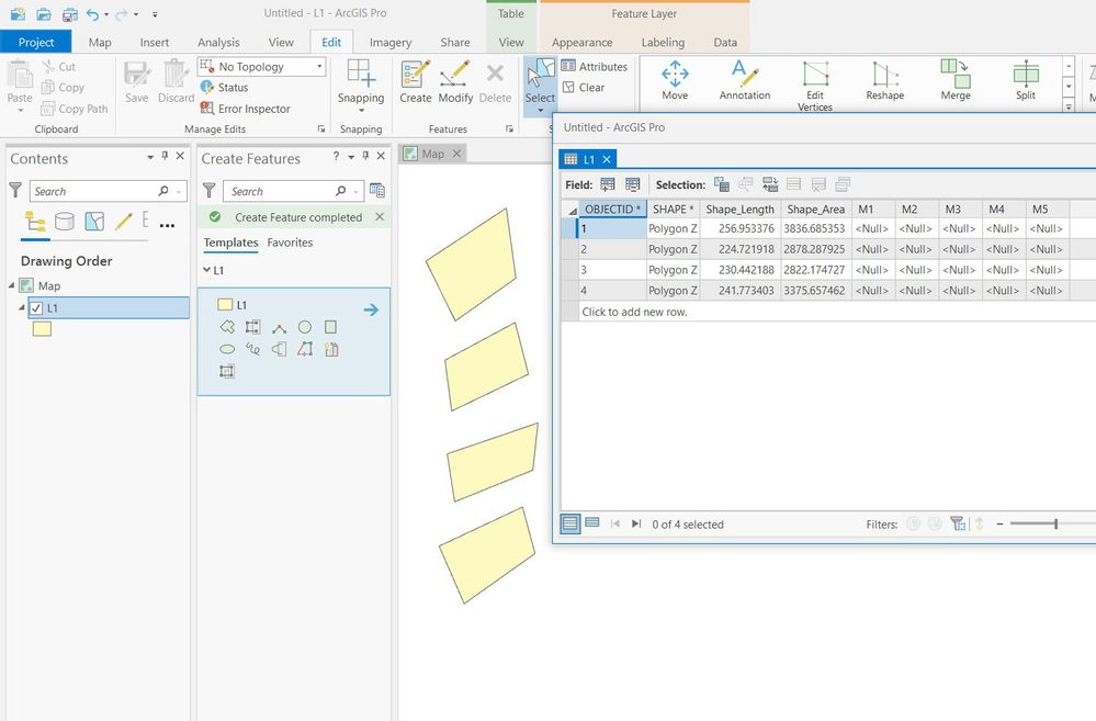

JamalNUMAN
Thanks Kory.

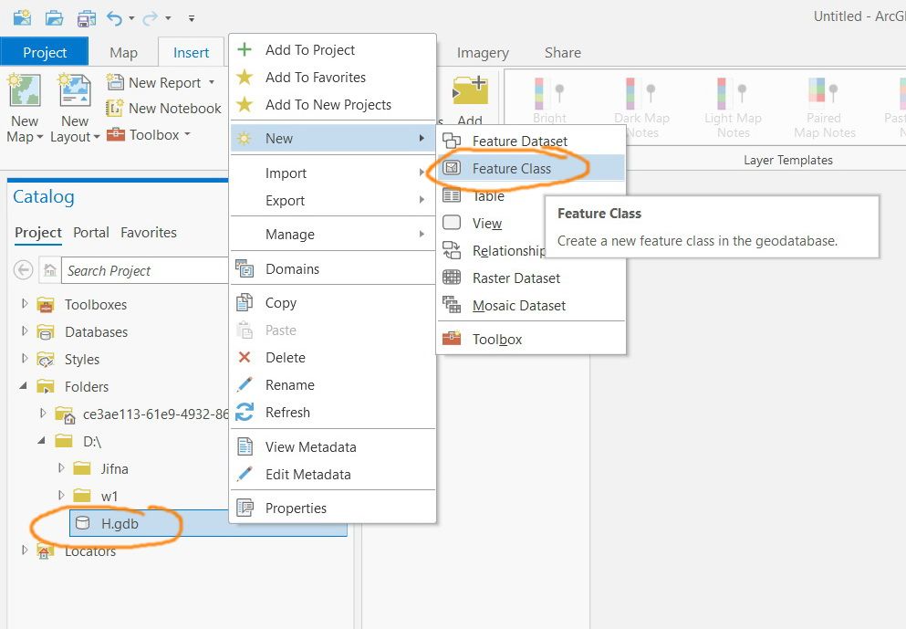

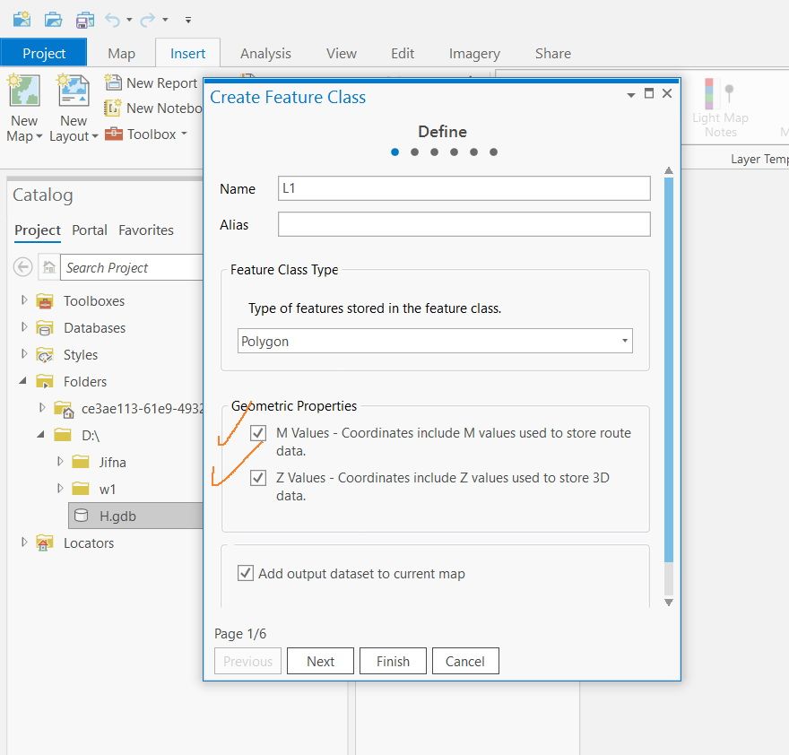

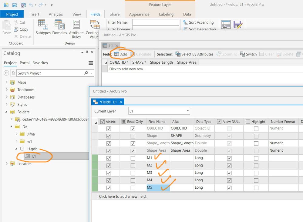

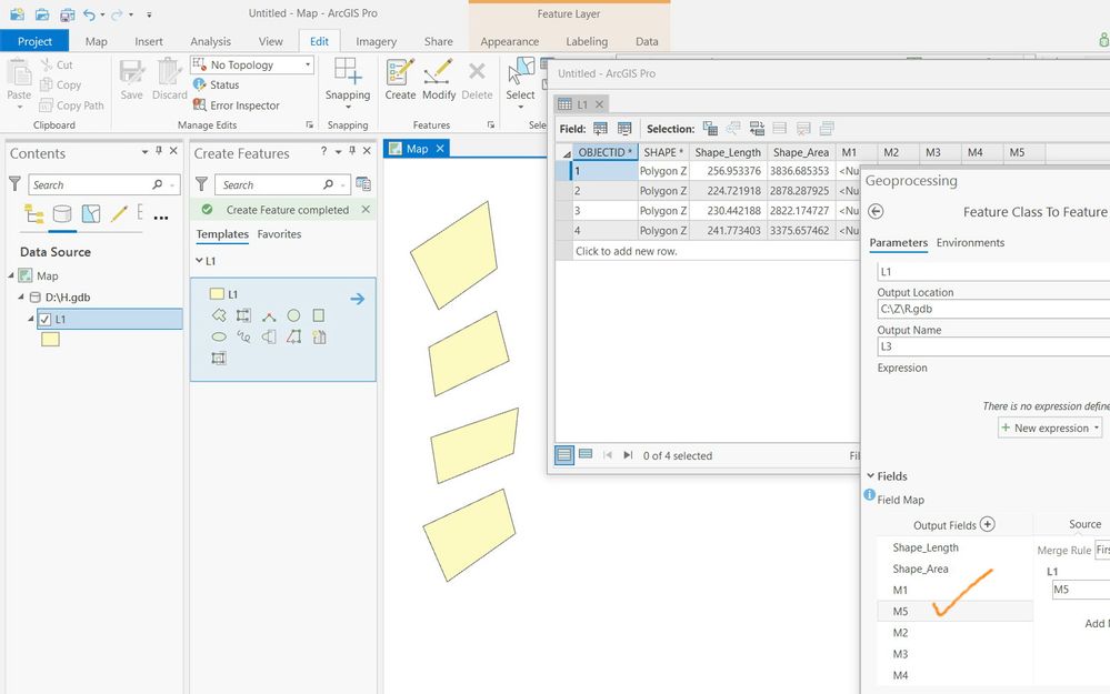

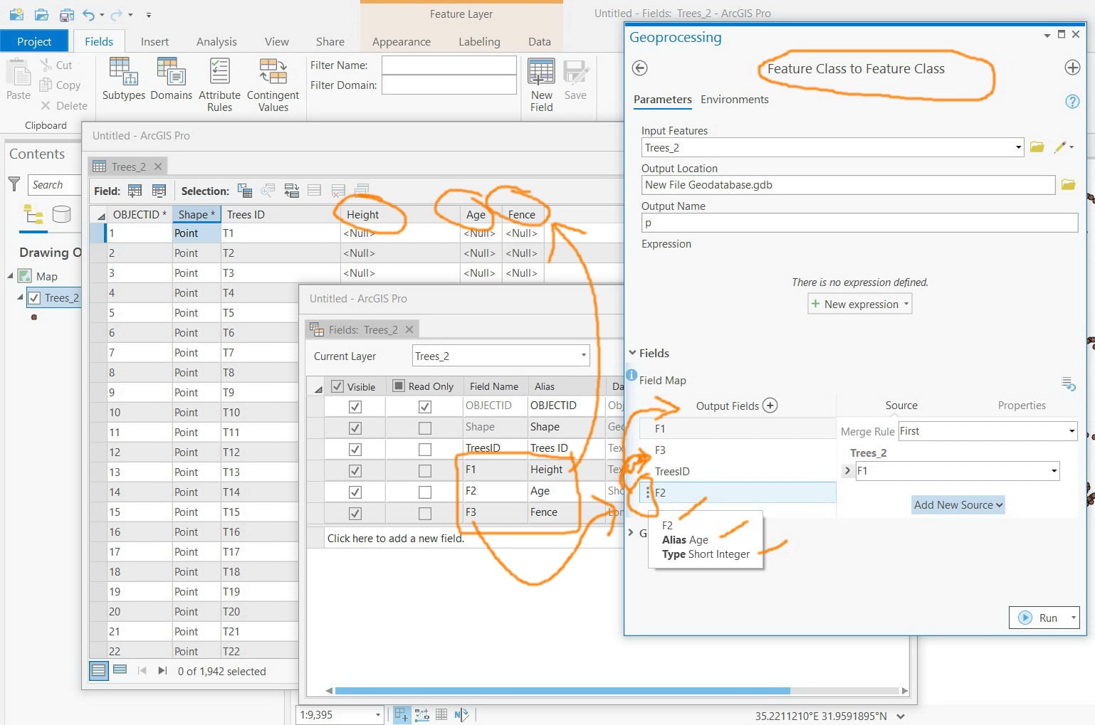

It’s quite straightforward to replicate the issue. The screenshot below gives a plan in how to reproduce the issue. Also, the feature class that never respects fields reordering is there in the link below
What do you think?
data:
https://www.mediafire.com/file/6to2mqvgigt2lo4/H.gdb.zip/file

OK, Jamal.
I gave it one last try with the data you sent.  The reordering works for me.
I think we're going to have to call it quits on trying to troubleshoot this on this thread.  It will require more in-depth troubleshooting if a bug is to be logged - and that will need to be done through technical support.
