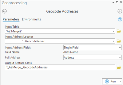

@KoryKramer , I don't see that optional parameters input when geocoding against our in-house/custom locator.
But it does show up when I chose the ESRI World Geocoding service. If I was using the ESRI service, do any of those options remove the annoying "USER_" prefix? I personally don't mind all of the new field that geocoding adds (e.g., match type, match score, standardize addresses). When I append the geocoding output to an existing feature class that doesn't have those fields, they are automatically excluded. But having to rename all of the fields that start with USER_ ain't fun!
