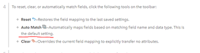

ShannonJ
Context: In ArcMap you have to select which layers you want to allow to transfer attributes and which attributes you want to transfer. The tool functionality in Pro auto-matches ANY fields that have matching names, across feature layers.
Example: I was trying to transfer the address from a street centerline to a water service box. A sewer main is drawn in overlapping the centerline feature. I had specified which fields I wanted to transfer from centerline to water service box, but had not set up or removed the field mapping for sewer main to water service box (I didn't know I would have to). When I went to transfer from the centerline, the sewer main selected instead (likely due to layer order) and transferred / overwrote four fields in the water service box that I did not want to update.
If the suggested workflow will be to set up appropriate field mapping for all layers it will be a lengthy process as I regularly have 50+ layers in a project, a lot of them with identical field names due to requirements by our AM software.
While I understand that this functionality is meant to be helpful, and I'm sure it is in some situations, I am suggesting the option to remove ALL auto-matched fields, rather than a layer by layer basis. If this is an option that I am just missing, please point me in the right direction. thank you!

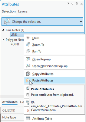

Scott_Harris
@ShannonJ Just some information that might be helpful/relevant to your recent experience:
1. You can uncheck layers in List By Editing (within the Contents pane) and they won't be modified by Transfer Attributes - or any Modify tool for that matter. One tip about this, you can right click on a layer in this view and get to the "Make this the only editable layer" command (which is just a quick way to toggle only one layer as editable).
2. The Field Mapping for editing goes beyond the Transfer Attributes tool. It is used by the Copy Attributes and Paste Attributes commands in the Attributes pane, as well as the Copy Parallel and Mirror tools.
3. Finally, you may want to consider using the Copy Attributes and Paste Attributes commands in the Attributes pane (instead of Transfer Attributes) for greater control of which features you want to transfer attributes to/from, as you can select specific features in the map and see them within the Attributes pane before pasting attributes.
Copy and paste attributes using the clipboard https://pro.arcgis.com/en/pro-app/latest/help/editing/edit-feature-attributes.htm#ESRI_SECTION1_B3B0...

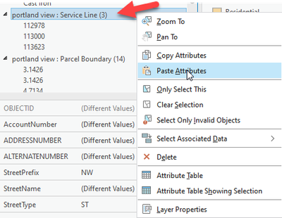

Scott_Harris
@ShannonJ
Regarding:
I create 40 new water services in a subdivision, all of which have a unique address identifier that need to be copied to the water service box. I now need to copy and paste attributes 40 times effectively doubling the amount of clicks to do the same work
Within the Attributes pane, you can paste attributes to multiple features (in the same layer) at once. I'm not sure if that applies to your situation, but it might be useful for other cases you run into.
Note how I'm right clicking on the layer and not a specific feature within the attributes pane
ShannonJ
Hi @Scott_Harris - I plan on using the copy attributes feature when all 40 are getting the same attribute transferred from a street centreline for example (which does happen), but not when all 40 need attributes from 40 unique addresses. Thank you for the suggestion, this will be helpful in a lot of cases.
