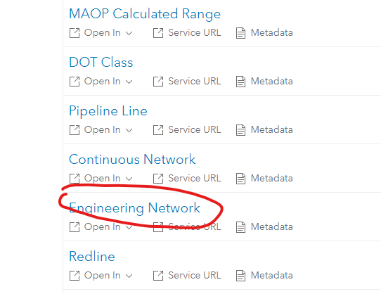

I've checked repeatedly, the map has an LRS network:

Michael Nigbor‌  Another point to verify: when creating the webmap for Event Editor - the Map Service should be added not the Feature Service. This is a common misstep and causes confusion.
Ayan Palit | Principal Consultant Esri
MichaelNigbor1
That was the trick! I used the feature service, instead of the map service.  Now my Event Editor is working.
