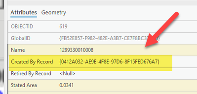

Are you tired of seeing the records' GUID value and want to see the actual record' name?

In my case I wanted to see the record names in a label, and since labels do not support feature sets in Arcade, I had no choice but to add the fields and use attribute rules to populate them.
In my expressions, 3 dashes  '---' are returned if no record name is found (e.g it's NULL).
