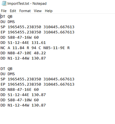

Any ideas on how to import multiple parcels at once using the Traverse import tool? Currently it seems you can only import a parcel at a time. I tried exporting 2 separate lots then stacking the text and importing that file but Traverse will only import the first lot.

Curious if any solution has been found?   I have a folder with 1200 "ArcMap Traverse Files" in .txt format. I can import them individually, each work great... but doing so manually is/will be a pain.  I've tried packing multiple into one file, but despite having a stated Start Point in X Y for each new line, ArcGIS Pro 3.1 acts as if the end of the last segment is the start point. I ended up with a continuous line with only the the first at the correct Start Point location.
